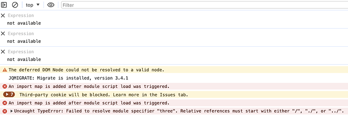

All of the sudden a plugin that has been working for the past 6 months without issues started throwing import errors yesterday. Below is how I’ve setup the imports (note they are in the “Shared” tab > “HTML Header”.

the error is clear: some module script is loaded before the importmap. inspect the page and see what it is. it can be another plugin or a browser extension.

open the dev tools and you can see what it is. use a browser without extensions
if you open a random bubble app you can see that bubble adds a script of type module now. that’s probably before your importmap amd causes the error.
import maps are nice but when you don’t own the page can have problems.
you can always load your modules directly: import stuff from "https://yoururl"
