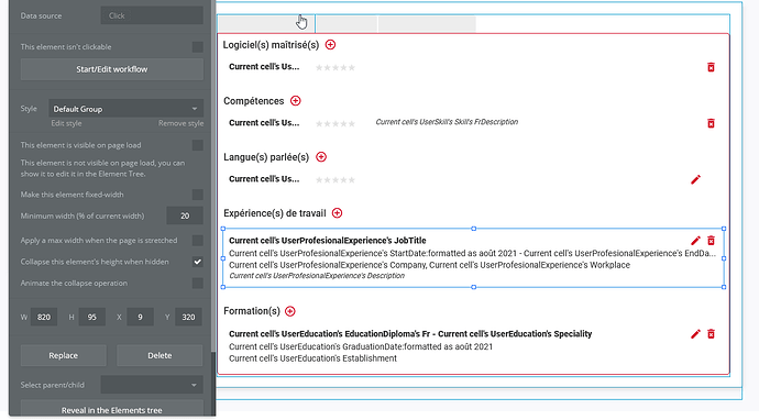

I currently struggling on how to hide a group and don’t have a withespace.
Here some screenshots demonstrating my situation:

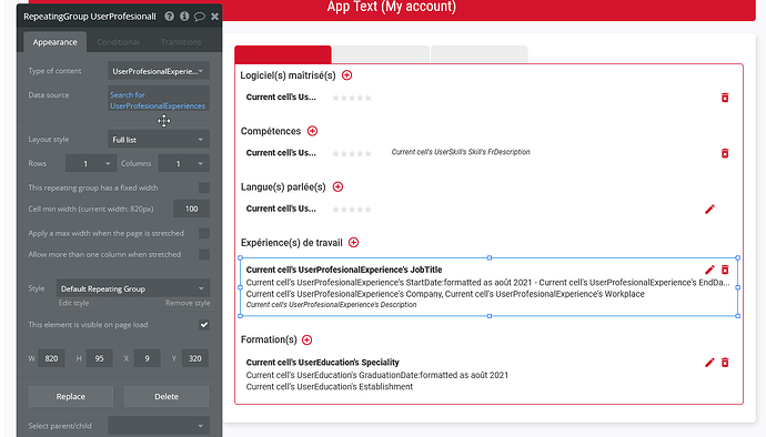

I tried to put the rg into a group and select “collapse if hidden” and hide it when nothing to show, but still a whitepace.
Thanks for help !

I second with @boston85719. You can make it not visible on the page load and then make it visible using conditionals. Or what you can try doing is select the checkbox of collapse the height of the element when not visible for every element inside the RG.

I’ve tried to put the group not visible on page load but still nothing is changing from the previous state.
I also tried you’re solution to select the checkbox for all element, but the only one that showing is :
Still no change.
Thanks,

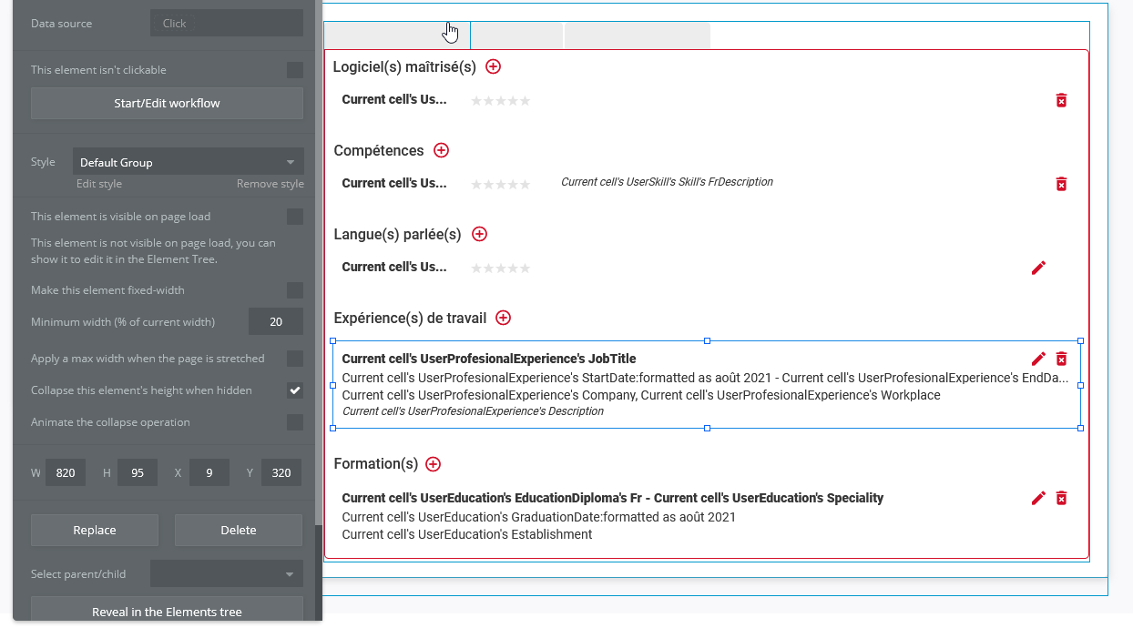

Hello, tried to put all text element in a group, still a whitespace.
Look at this gif showing the inspector: the group is hidden but still having space

Finally, it was the red text creating a big whitespace without clear explanation.
