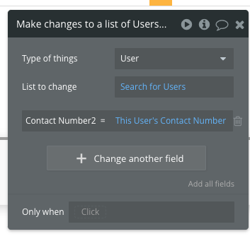

Screenshot 2023-09-09 at 16.45.19
I also tried this.
You’re missing a valid value (hence the red error)
The value for Contact Number 2 must be a text value.
Also, you’re using ‘Make Changes to a list of things’, instead of ‘Make Changes to a thing’…
Which, i guess is another way to do this, but it’s not what I was talking about in my previous post.
But if that’s what you’re doing instead, then there’s no reason it shouldn’t work.
So what do you mean when you say you tried it?
If it didn’t work, check your server logs to see why (if you’re doing it that way, privacy rules could be an issue).

I’ve got no idea what you’re doing with the set slug action, or what that has to do with anything?..
In any case, if you’re using Make Changes to a list of things, you don’t want to do that as a bulk action…
Just run it as a regular workflow (either backend or client side).
