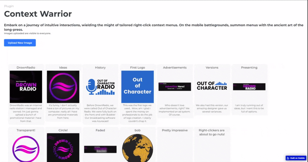

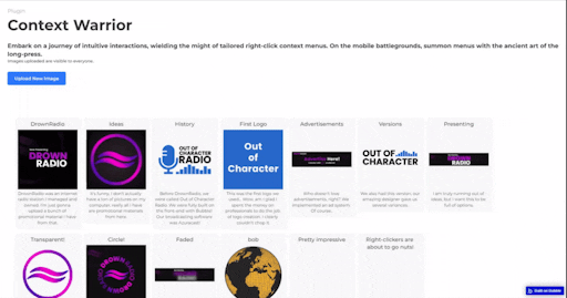

I just duplicated a similiar-ish type setup, and the experience I am having is that the context menu will appear when I right click on the specific elements, however the incorrect data from the cell is being passed.
For example, here I right clicked on this image:
and when I click edit, I actually get the details of:
Which is another image.
Just want to make sure this is the same issue you are facing.
