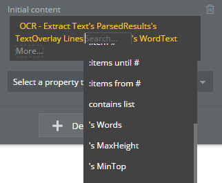

Hi @jarrad,
How do I get to textOverlayLines? Do I have to toggle / enable some setting to see it in the menu? In my drop down, i’m only seeing this:
Thank you!
