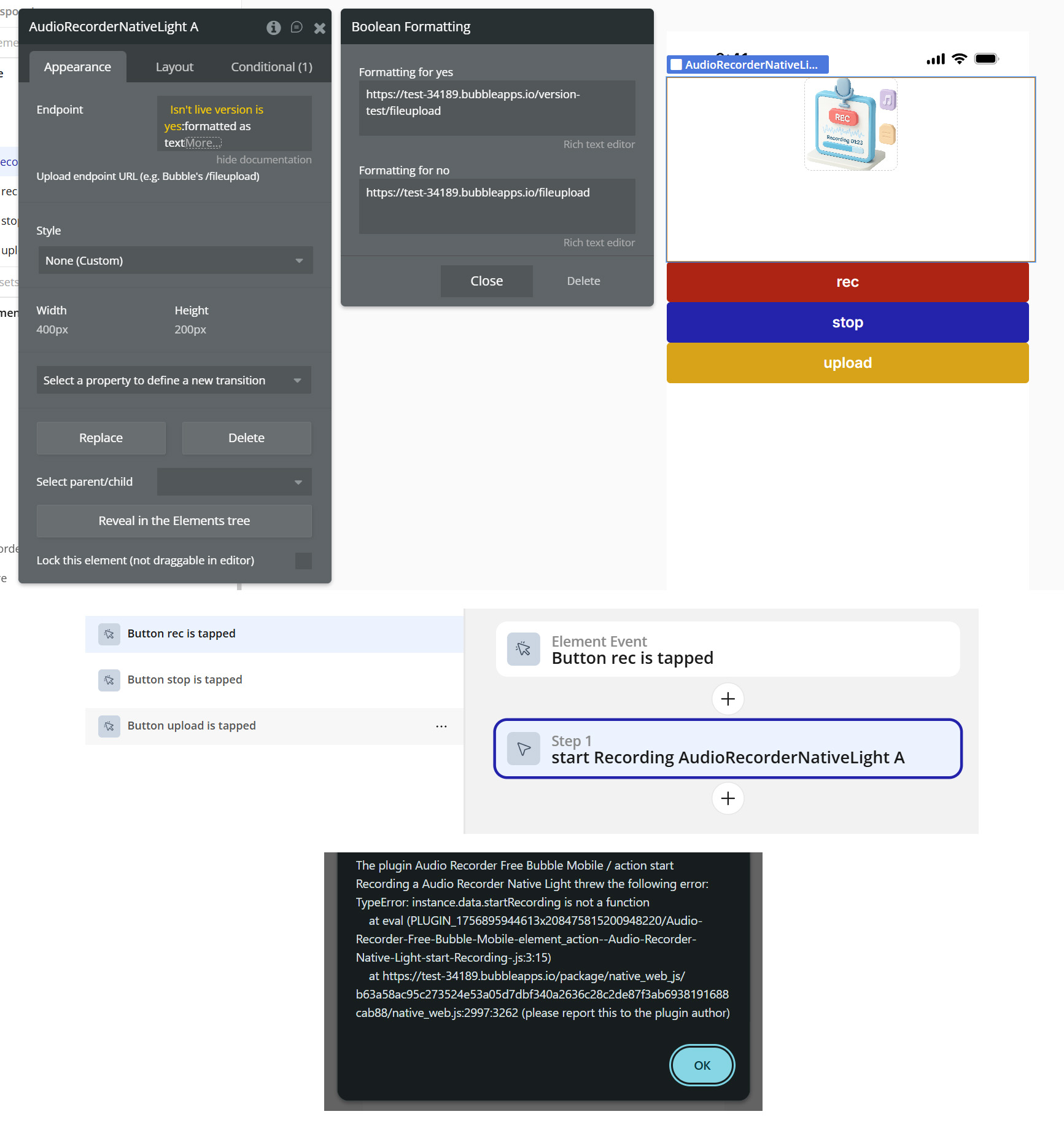

Unfortunately, I'm unable to use your plugin at the moment. I get an error when trying to use it in both the project and the demo version. What could be wrong?
Hi @journal.424242 :waving_hand:
Thanks for reporting this. The errors in your screenshots - “Cannot read properties of undefined (reading ‘prepare’)” and “instance.data.startRecording is not a function” - usually happen when the recorder element hasn’t been initialized by the environment. This plugin is a native-mobile one, so it needs to run on a real device (Bubble’s native wrapper/Bubble Go or any webview wrapper) with mic permissions granted. Running it in a desktop browser or triggering the action before the element is ready can cause exactly those messages.
Before anything else, please simplify the setup:
  • In AudioRecorderNativeLight → Upload endpoint URL, use a plain text URL (no “formatted as text”, no data-type conversions):
    • Test: https://YOUR-APP.bubbleapps.io/version-test/fileupload
    • Live (custom domain): https://YOUR-DOMAIN/fileupload
      This avoids type conversions that can resolve to empty/invalid values and break the upload.
Quick checks:
  • Test on a physical phone and allow microphone permission.
  • Keep only one recorder element on the page and make sure it’s visible when you call Start recording.
If the issue persists, please share:
  1. How you’re previewing (Bubble Go/webview vs desktop browser), device & OS.
  2. A link to a minimal test page and full screenshots of the element setup (Appearance/Conditional).
  3. The exact workflow steps calling Start recording and Upload to Bubble.
We’ll reproduce and advise next steps.

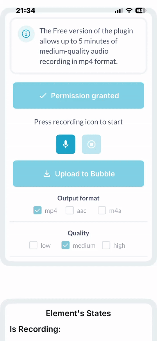

Thank you for your patience while we reviewed your setup. I checked your workflow, and it appears to be configured correctly—both the recording and the “spot” actions align with what’s recommended in the documentation and the demo page.
The main difference between the working version and yours is that your implementation doesn’t trigger an explicit microphone-permission request. You mentioned that you’ve granted microphone access, but on many modern devices/browsers microphone access still requires an explicit user interaction (for example, a button click) to prompt the permission request. Granting permission only in the device settings is often not sufficient.
When I previewed your app in the browser, it didn’t prompt for microphone access at all.
Could you please check this first and ensure the permission request is triggered on your test page? Once implemented, let us know whether the issue is resolved on your end.
Looking forward to your reply.

Hello @brenton.strine :waving_hand:
Apologies for the delayed response. We’ve just received an update from our development team regarding a newly published release—version 1.10.0 of the Audio Recorder Free plugin for Bubble Mobile.
This update includes several improvements, including a fix related to recording via the microphone library, which may have been the cause of the issue you experienced.
Please update the plugin to the latest version. After doing so, the action to request microphone permissions should be available on your end.
As mentioned earlier, modern devices may require explicit permission requests to prevent unauthorized background microphone access—this is a built-in security measure to protect users.
We’ve also rechecked your demo page and reviewed the project’s Permissions tab, confirming that microphone access is enabled. At this point, there are no differences between your setup and ours, so the issue should now be resolved.
Please let me know once you’ve had a chance to test it.
