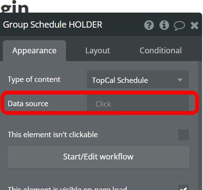

Ok, more questions/issue… I can now see the date highlighted on the calendar when I post availability in my simple app, but when I refresh the page, it goes away;
You can see that all the dates I posted are still in the database and are showing up in the RG;
In that Calendar, I am guessing it’s Data Source is Empty on page load. In the Workflow you showed before you are Displaying a Room in the Group Schedule Holder only after it is Created. So refreshing the page would reset that Group to be blank until an Action displays something in it.
Or you can set the Group Scheduler Holder’s Data Source to be set on page load by filling in this field:
