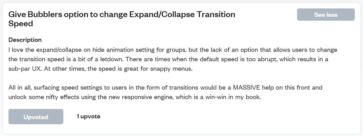

Any chance that there are plans to let users set expand/collapse transition speed like we can with borders? The current collapse settings are somewhat abrupt when viewing lots of text, and there are times when I might want it to go slower/faster.
Just posted an idea on the Ideaboard for this too in case anyone wants to upvote:

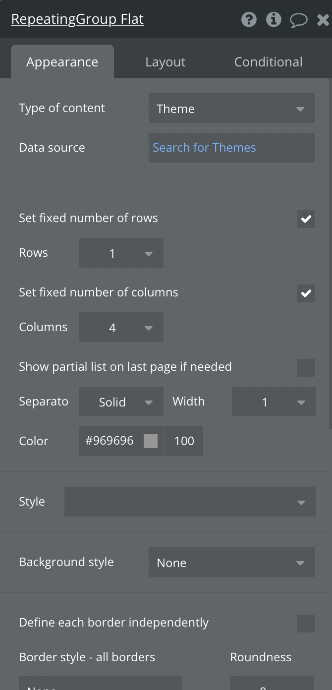

is it somehow possible to set the fixed number of columns in a horizontal scrolling repeating group to a value like 4.5? I want to achieve that half of the next column is always visible.
When I set it as example not fixed but to a minimum of 22.2 % to achieve it, many horizontal groups below eacht other, the columns do not have the same width unfortunately.
as you can see columns are not the same width, is this a bug?

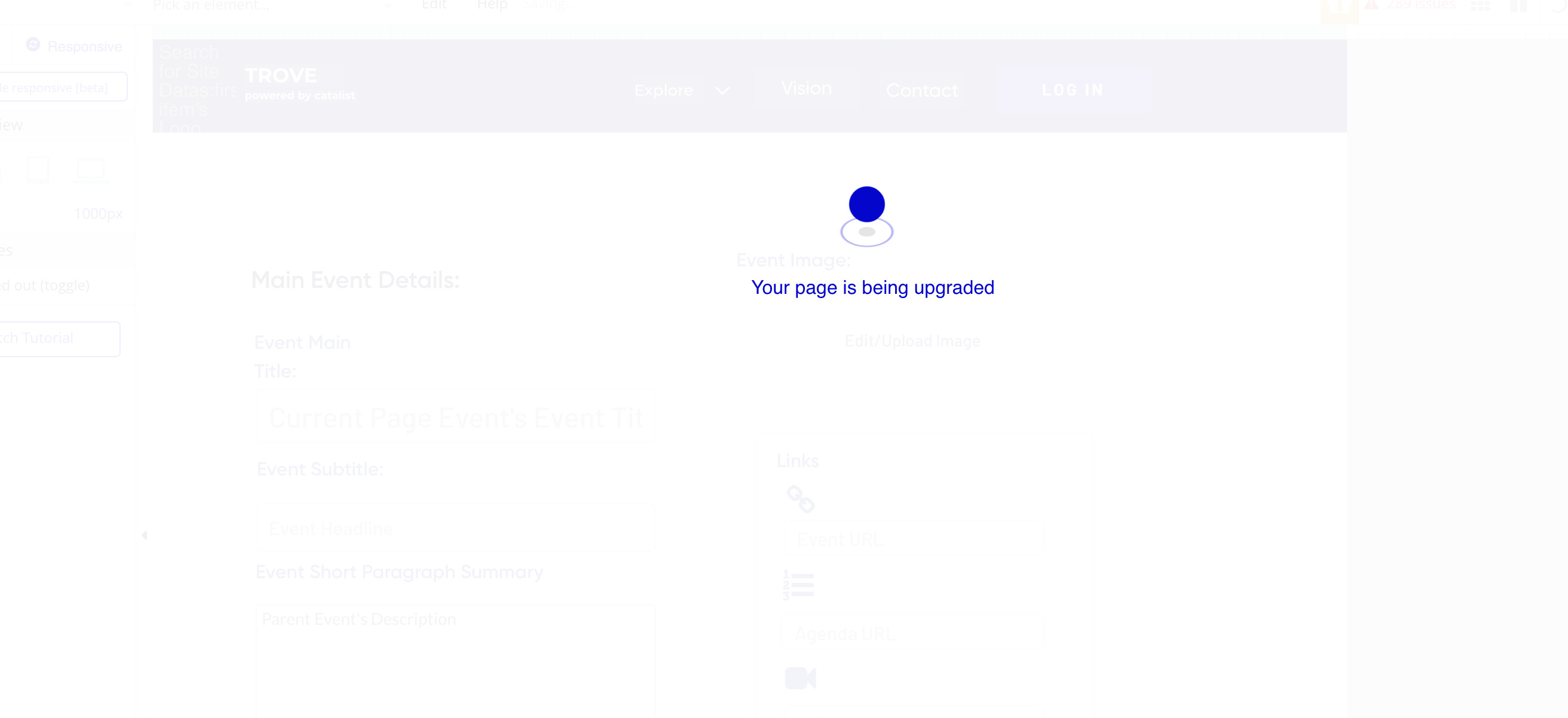

How long should this take? Sometimes for complex pages this has been updating for up to 30 minutes and I’m not sure if i should wait. Should i leave the page open? If i exit the browser will it cancel? It seem yes since when i exit the browser and come back i see that the page isn’t created. This is only an issue for me when restructuring the page to match existing behavior… If i continue using bubble in a new tab will this mess things up? Thanks!
It will never finish. But I am surprised that you are still facing the issue. I had same problem and reported a bug for this. Support staff confirmed it to be a bug and fixed it and my page was migrated after that.
Maybe bug is not fully fixed. I suggest you report it to the Support.
By the way I personally found that unchecking “restructure” option worked better for me to migrate the page “as is”. Restructure option created unnecessary groups and it had things broken which I needed to check one by one anyway and fix.
Yeah I left it open for a few hours and it doesn’t ever go away. I’ll submit a bug report thanks!

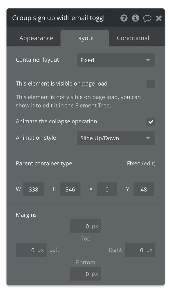

For some reason some groups, even brand new ones, don’t have the “make collapsible when hidden” checkbox under their “Layout” tab. What’s weird is that some of them do have the option to animate when hidden. Is this a bug?
It’s because the parent container type is set to fixed.
The parent container needs to have a responsive layout for collapse when hidden to be an option.
