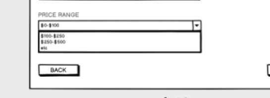

I want to create a dropdown whose elements are numeric ranges like below:
image,
i.e. sth like: 0-50, 50-100, 100-200, +200.
This solution here works in principle but e.g. you cannot have a last option of “+x” that considers all numbers higher than x.
I tried to create an option sate of type numeric range but unfortunately there is no such thing. How should I go about here?
