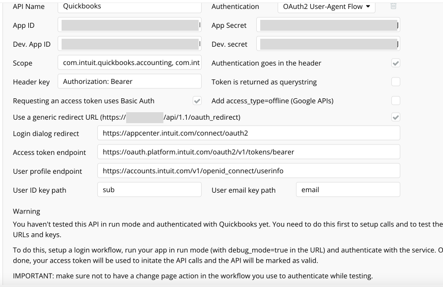

I’ve been reading through Quickbooks OAuth 2.0 Authentication guides and I feel like I’m super close but I’m getting these errors when trying to authenticate via the sandbox environment to move on (screenshot below of errors I get).
Can someone help identify what I’m doing wrong in my workflows/API connector setup? Many thanks!

I think url for user profile is accounts.platform.intuit.com/v1/openid_connect/userinfo
(missing platform in url)
Don’t forget to have openid in the scope list
Hey Jici, thanks for replying here, I switched to that URL you recommended but it still seems to have the same issue. Here are the scopes that I have in Bubble:
com.intuit.quickbooks.accounting, com.intuit.quickbooks.payment, openid, profile, email, phone, address
These are also the selected scopes in the Intuit developer portal for the app I made:
Hum, I don’t remember the settings directly in the QBO settings.
How did you separate them in the scopes in API connector? Also, can you share the auth screen from QBO when you try to login? Normally, it should show the list of scopes

For the scopes, I’ve copied and pasted exactly what’s in the API connector right now: com.intuit.quickbooks.accounting, com.intuit.quickbooks.payment, openid, profile, email, phone, address

From the screenshot, I can see selected scopes doesn’t include the openid stuff, so maybe it’s why.
Maybe try to create another app and be sure to select all the scopes if there’s more
Finally, Got access tu an old dev account. And the scopes seem to be fine I think. But the scopes seem to also be set in the production. So if you use your production key, you need to remove sandbox- from the url for user endpoint.

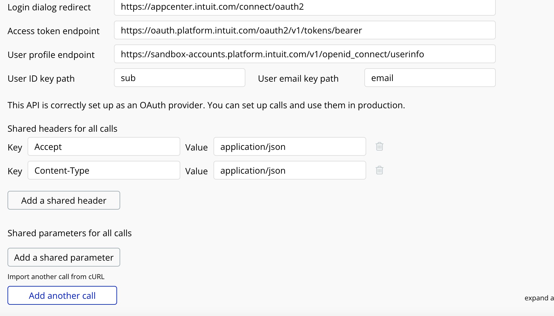

“Add the sandbox user profile endpoint url”
I added the “sandbox-accounts….” URL since this is the sandbox account, and it then gave me this error when trying to go through the OAuth flow:
Finally, I un-checked, “Requesting an access token uses Basic Auth” and it looks like I was successfully authenticated… received this:

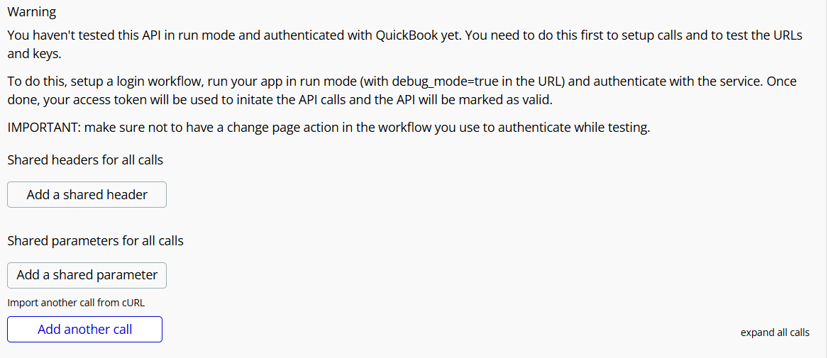

Going back to my API connector setup, it looks like that language saying, “You must authenticate before you can do anything” is gone.
Follow up question now that the sandbox OAuth is properly configured:
  1. For production, would I simply input the production Client ID and Secret keys into the production fields and be good to go?
  2. Or do I then replace the user-endpoint URL with the normal production URL when I eventually deploy this out?
  3. Neither 1 or 2, but something else?
Thanks so much!
You will need to set your live key but also set the production user endpoint url (that is just done by removeving sandbox-
