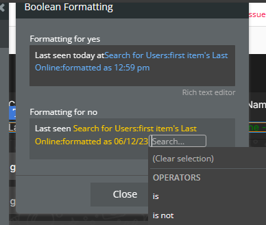

how do i get this is this static text?
This search would always return the same User no matter where this conditioanl is being evaluated.

Just tryed @ri_scc_94 formula :sweat_smile:

new to this condition type don’t know what the brackets mean
Oh, this formula should be in the text, not in the conditions…
yep just found that out ha
