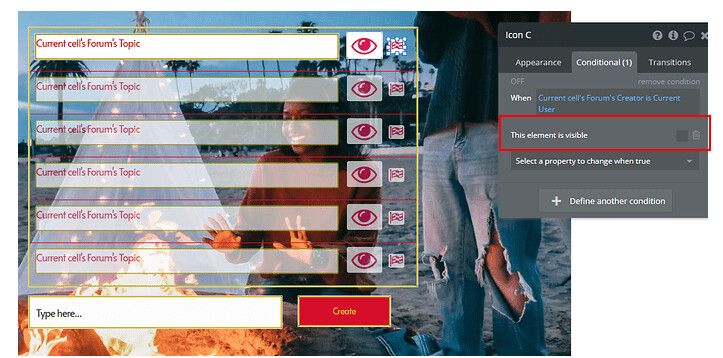

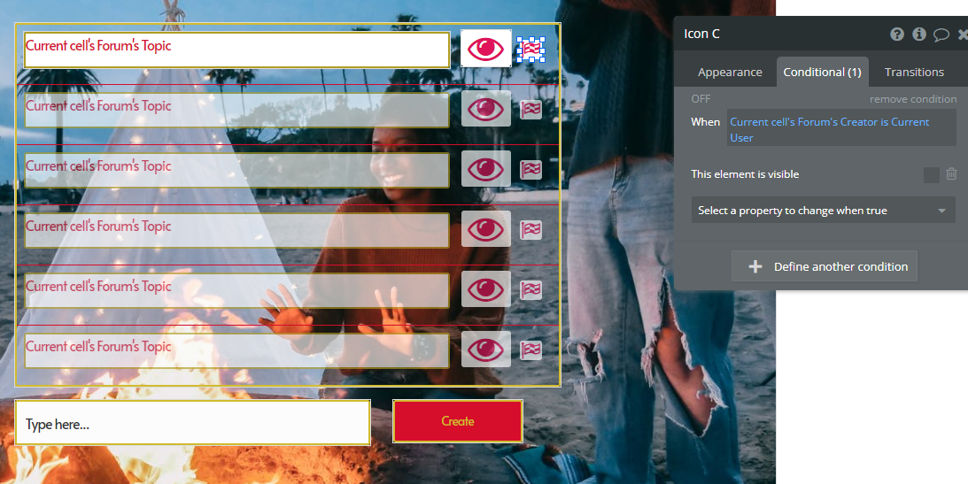

Thanks for the suggestion, much appreciated. I have done this, but the icon somehow shows for other users instead of the creator?
Then you must have done it wrong…
Double check your settings to try and locate the error.
Feel free to post some screenshots (or a link to your editor) if you’d like someone else to take a look for you.

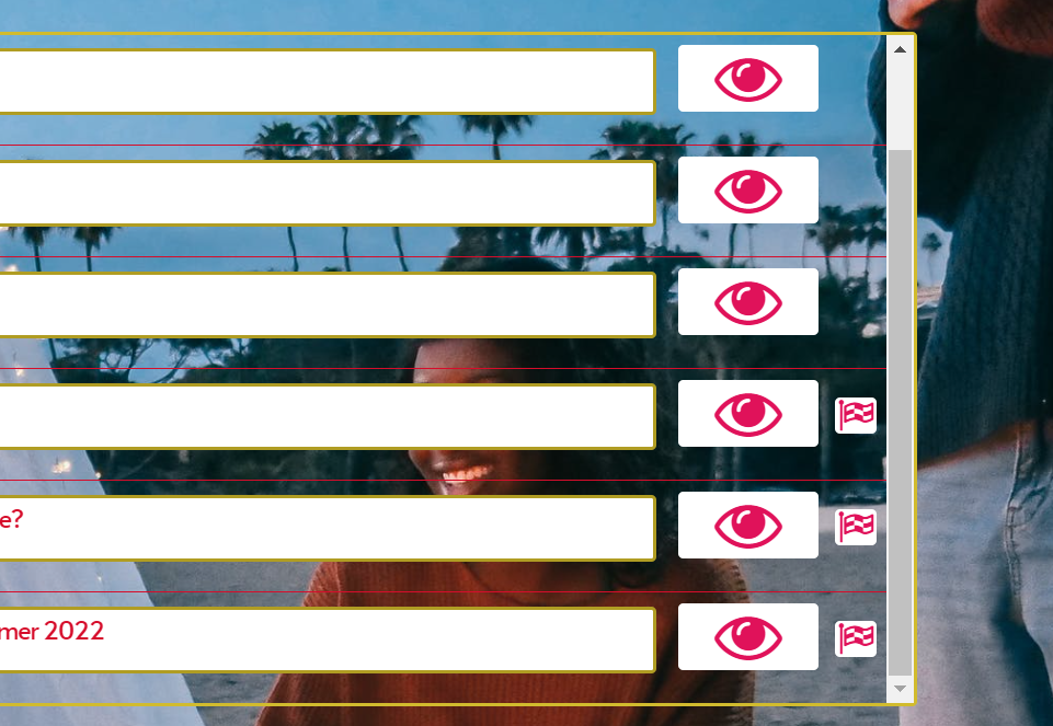

The flag is only meant to show for the creator, however on the view page, the flag is showing on content created by another user? not for the content created by the user signed in?
mikeloc
6
Hi there, @alendedja79… maybe I am missing something obvious, but if I am seeing things correctly in your screenshot, you need to check the This element is visible box in your conditional, and you need to make sure the element is not visible on page load on the Appearance tab.
Best…
Mike
As @mikeloc pointed out, you haven’t checked the ‘Element Is Visible’ box to show the element.
I’m guessing you’re showing the flag by default on page load, then hiding it when the current user is the content creator - which is exactly the opposite of what you want to do.
So just switch that around and it should work.
Thank you @mikeloc & @adamhholmes
That worked, I have learnt my lesson!
