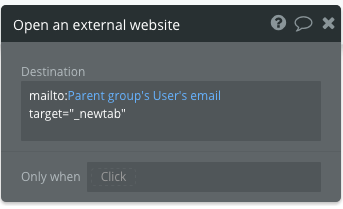

Sorry to open an old thread, but I figured it’s better than opening a new one. Can I ask you how you did that? I’m having trouble getting it right. I tried this with no luck:
The mailto works, but not the _newtab.
You can use the Link Element to open in a new tab.
As Emmanuel mentioned, I do not believe it is possible from the workflow to make it open in a new tab

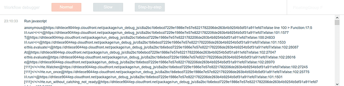

I just tried this and bubble runs into a bug when running this javascript.
Is there a solution to make this work?

I get a lots of error messages when clicking the image that runs the js.
Solved.
I copied and pasted the code from here and I guess there are extra spaces that caused an issue.

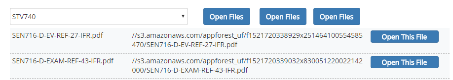

and @codurly does this javascript run from an API on a list? I need to be able to open a batch of files so I am trying to get this to run on a list. I’ve spent the past several hours trying to make it work from a workflow API but have been unsuccessful. Using the javascript described above works just fine for me one file at a time.
So I created a dummy page to show the various ways I’ve attempted.
The Open Files buttons up top are the API trials. The button inside the RG is the single file javascript that works.
Here is the editor link for the page.
Version-Test link.
Sure hoping this can be done.
