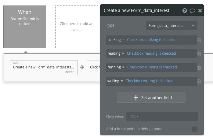

Option (d) - Checkbox data stored in its own data type, with that data type stored in a field
Here’s the workflow (2 steps):
  • Step 1 - create new ‘thing’ storing the four yes/no values
  • Step 2 - store step 1’s ‘thing’ in data type that also includes name & age fields
    The results also seem to work, and is perhaps easier to work with than Option (c) with larger sets of checkboxes, although I’m not yet sure. The results in 2 pics:
