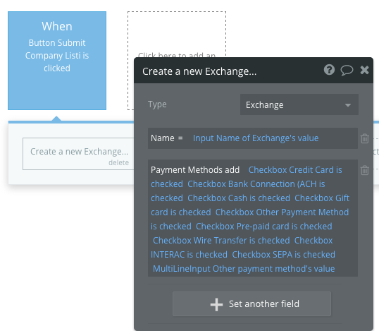

To which, I tried this:
When the big Submit button on the form is clicked, it creates a new object of type “Exchange.” Exchange currently has two fields called “Name” which is text, and “Payment Methods” which is a list of texts as you suggested. Then I added all the relevant checkboxes for Payment Methods.
But that’s not quite right. So I’ll let Emmanuel chime in. Thanks!

I think doing it this way means that you would have to create the “Exchange” object on page entry, and then modify the currency list array as each check box is changed.
If you add them all at “Create” time as you have done above, using “is checked” then you will get a list that looks list yesnononoyesnoyesyesyes … which isn’t that helpful I don’t think. When really what you want (I think, correct me if I am wrong) is a USDCADGBPEUR list ?
As it stands (although development is rapid and this may have changed) we don’t have a way to say …“If this checkbox is checked then put USD in this field” … for a list of fields. We have to store the “list” somewhere each time something changes. Currently the best place to put this is on an object using it as temporary storage.

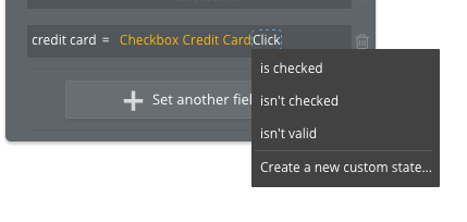

I guess one of the reasons I’m confused is because I’m trying to store the value of the checkbox (in yes/no format), and in this tutorial video that seems possible (at 3:14): https://vimeo.com/66072019
But in my app, that option doesn’t exist:
The “value” of Negotiable is still Yes / No though, not anything else. I think that may be an older UI, as now you can set yes / no as to whether it is checked or not (i.e. not every check mark can mean "Yes).
