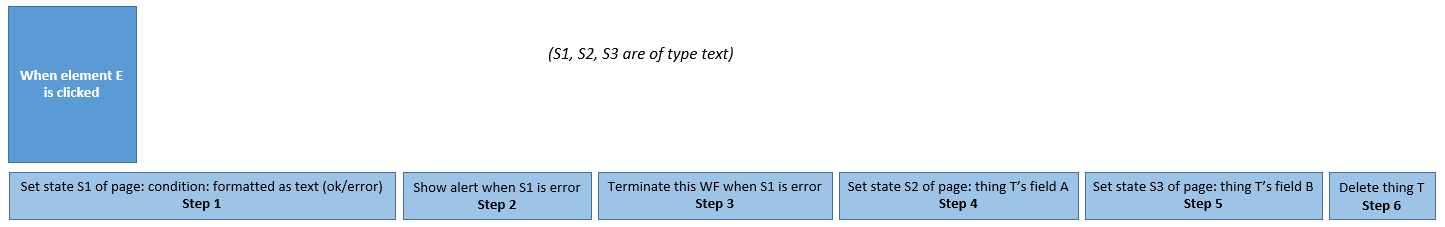

I built my app under the assumption that the actions of an event make effect one after another (following the order) and not simultaneously.
When testing my app, this logic seemed to be indeed applied, since I never noticed before a behaviour that could contradict it, until lately with this example:
Without understanding why, I noticed that in this case, step 6 makes effect before steps 4 & 5.
That’s a problem because steps 4 & 5 depend on the thing deleted in step 6.
In the same way, it would cause an issue every time a previous step refers to a thing, before its changes ordered in the following steps.
Thus, I’m wondering if it’s a bug or if it means that I have to review the workflow of all my pages.

Thanks @sridharan.s for your reply! Sad to hear that, it would be so much easier to have successive actions.
@mebeingken thanks for your adivce! If you have time, could you please suggest how to apply your tips in the specific case described above in the first post, just to have a concrete example and understand better how to adopt best practices?
So, you mean that custom events are triggered after regular actions?
As for the action “Terminate this workflow”, it seems way less useful, without the guarantee to respect the order.
A little difficult not seeing your app, but I would try this for starters:
Create a new custom event, and move step 6 into that custom event since you want that to run after 4 & 5.
After step 5 (now the end) make a new action, Trigger a custom event, and point to the event you just made.
Oh, and I forgot to mention using the Add a pause before next action, action. If the above works, great. If not, try inserting a pause before step 6 – my guess is something like 250ms will be enough. The docs say the pause is only for actions happening on the screen, but it has worked for me when I thought it might not!
Ok, thanks, but if we follow this rule, we should also be careful with step 1, right?
Indeed, if there’s no guarantee that step 1 happens first, then it could affect all the other actions, since they all depend on the status ok/error of the custom state defined in step 1.
Also, about your tip in the “when condition” area, do you have a usecase in mind for example?
I think it is more about being careful with dependencies, not specifically step 1. If an action is dependent on a previous action, one has to consider the impact of those happening in an order not anticipated. Perhaps in your example it all stems from step 1, so perhaps you are correct here, but it really is about dependency. If everything depends on that state, you might want to set the state, then call another custom event. The truth is, some times it is fine, and sometimes it bites you. Some actions take longer than others, etc. I even see differences in debug mode vs. run…so I tend to plan for the worst. By the way, you can also define a custom event with a type of thing parameter, which allows you to pass it a value. In your case, you could pass the value into the custom event from step 1, which in and of itself, will create a dependency you can count on.
