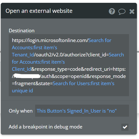

  4. If the user is a new user, sign in the new user (user DB populated with new user credentials) and formulate a URL call to obtain a user ID code (first step in Oauth2 process)
(Note that I attach to the URL request a state that is the user ID in my application. This enables me to correlate the returned user code to the correct user).

Thank you @cmarchan for your reply and assistance. The included reference from ambroisedlg was most helpful and I was able to make some adjustments to more closely emulate the same workflow function.
What I am struggling with now is that when I am running my workflows, capturing the user email address and then doing look ups and to qualify against their Microsoft tenant (Oauth API calls and getting an access token, then MS graph/user API call) as a ‘qualified user’, the workflow is functioning without any ‘logged in’ users. As such, as I attempt to do data searches (building external URL with tenant ids, redirect URL’s etc.) from the DB in the various workflow steps, the searches are coming up empty when running in the live environment. I also are unable to add data to an existing user record. I believe this to be related to the authorized access to the DB (accounts and users) and how privacy rules are set up when there is no logged in user. I will research the forum for a solution for this as I am certain this has been experienced by others, but if someone can direct me to a forum solution that would be greatly appreciated.
