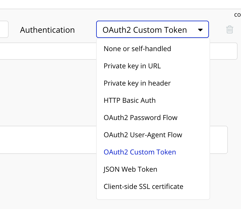

I see this in Bubble:

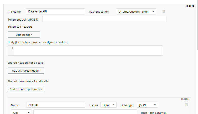

But not sure which to pick and then when I do pick one I’m not sure what to fill in. I tried OAuth2 Custom Token but that then wants a Token Endpoint (POST) URL which I’m not sure which one I use, nor where I even put the access token. Appreciate any help!
Most of the time, in Bubble if you need to use oAuth2 and let your users access their own account, you should use User-agent Flow. Normally Postman is using this when you configure oAuth2.
The last screenshot show you the final result of the oAuth2 process. If you want to directly use this (if you can… not sure and most API have an expiration for access token), you should use private key in header. The key will be Authorization and the value will be dynamics365token accesstokenhere

Yes. So you are using only your own dynamics instance from what I understand and will access your account data and this access need to be done even if you are not logged in (when it’s a different user that is logged in).
I think the best option for you is probably to use oAuthcustom token with info from this page.
It may probably look like:
https://login.microsoftonline.com/{TenantId_or_Name}/oauth2/v2.0/token?client_id=6731de76-14a6-49ae-97bc-6eba6914391e&scope=user.read%20openid%20profile%20offline_access&username=MyUsername@myTenant.com&password=SuperS3cret&grant_type=password
Maybe the oAuth2 password may work too.
In this case, this will probably look like this
https://login.microsoftonline.com/{TenantId_or_Name}/oauth2/v2.0/token?client_id=6731de76-14a6-49ae-97bc-6eba6914391e&scope=user.read%20openid%20profile%20offline_access&grant_type=password
and you need to enter your username and password in the correct fields.
Other auth are also possible but will ask you to manually handle each part and store token into DB.
Don’t forget to change scope according to what you need

@Jici can i ask for a more specific way on how to do it please?
Like what should I put in the empty inputbox?
Im not good at understanding a more complex english sentences so the microsoft documentation is a little bit confusing
