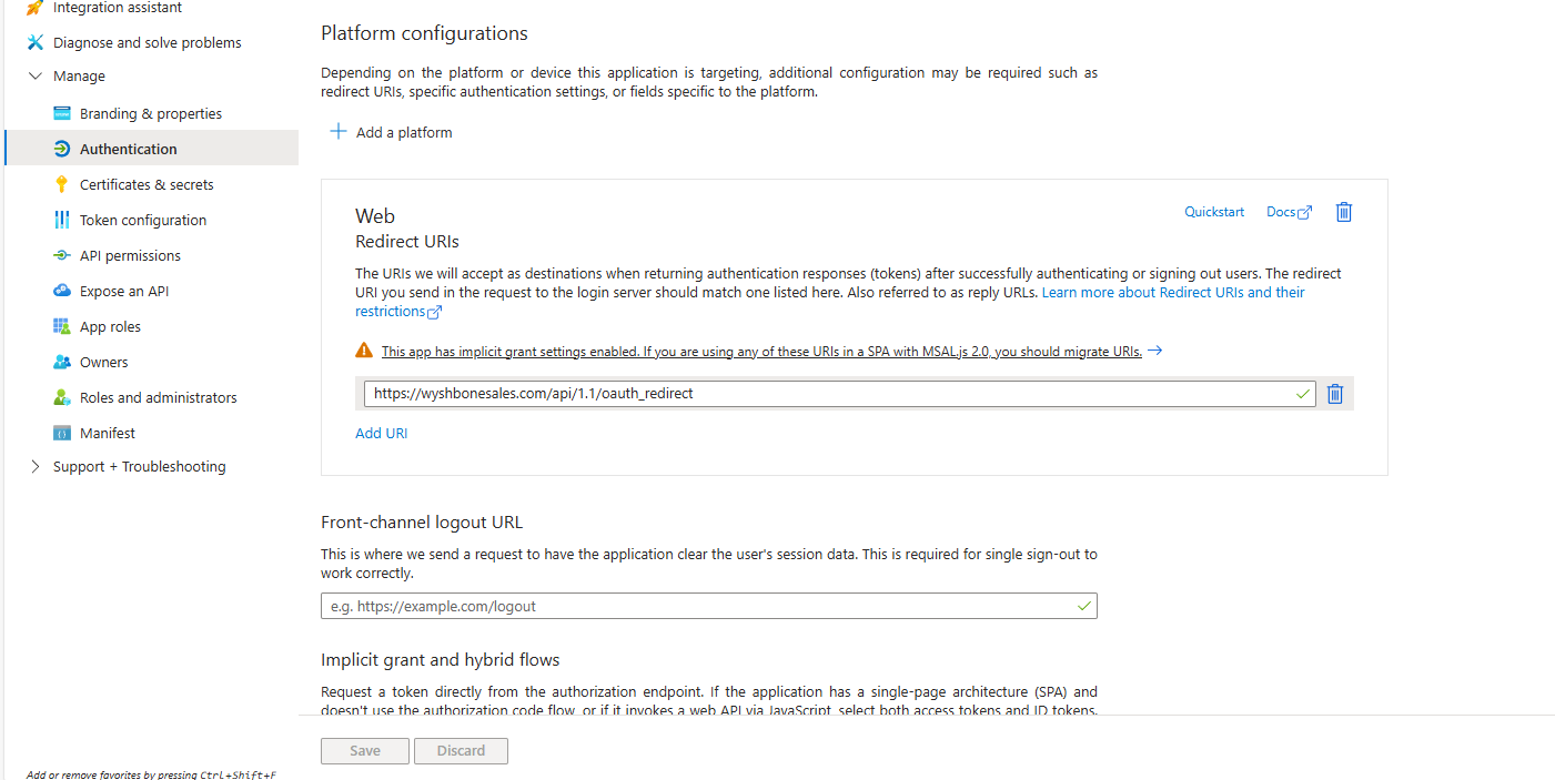

I’m trying to connect my Bubble app to Microsoft Dynamics 365 Business Central API using Azure OAuth2 authentication via the Bubble API Connector plugin.
What I’ve done so far:
  • Registered my app in Azure AD and set up OAuth2 with the following:
    • Authorization URL: https://login.microsoftonline.com/organizations/oauth2/v2.0/authorize
    • Token URL: https://login.microsoftonline.com/organizations/oauth2/v2.0/token
    • Redirect URI configured both in Azure and Bubble to https://wyshbonesales.com/api/1.1/oauth_redirect (plus some variants for debug/live branches)
    • API Permissions granted (including Financials.ReadWrite.All, offline_access, and User.Read), with admin consent granted.

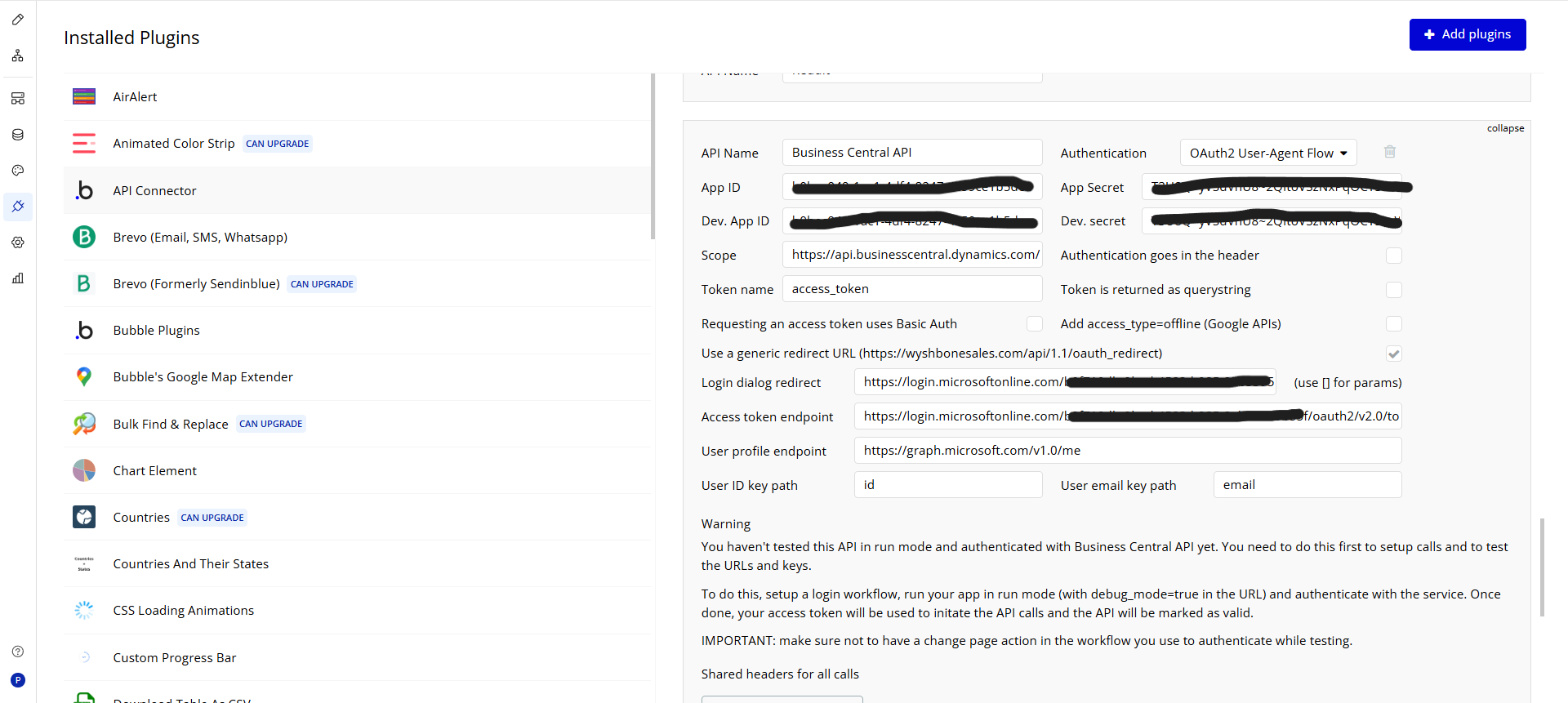

  • Configured Bubble API Connector for OAuth2 User-Agent flow:
    • App ID and Secret from Azure
    • Scope matches Azure scopes
    • Token name set as access_token
    • “Token is returned as querystring” unchecked
    • “Use generic redirect URL” unchecked to allow manual redirect URIs for different app versions
  • Created Bubble workflow with “Signup/login with API - Business Central API” action to perform OAuth handshake
The problem I’m facing:
  • The OAuth handshake completes successfully, and the token is returned by Azure (confirmed via raw response in Bubble debugger).
  • However, subsequent API calls in Bubble fail with the error:
    "missing access_token" or "InvalidAuthenticationToken: Access token is empty"
  • It seems Bubble is not properly picking up or using the access token returned from the OAuth handshake.
  • I have checked the token name, endpoints, scopes, and permissions multiple times.
  • Tried saving the token explicitly to a user field or custom state, but API calls still fail.
  • I’m not sure if I need to configure anything else in the API Connector or Bubble workflows to make Bubble pass the token in the Authorization header properly.
What I’m looking for:
  • Advice or examples of working OAuth2 setup in Bubble API Connector with Azure AD and Business Central.
  • How to ensure Bubble correctly captures and uses the access token for authenticated API calls.
  • Confirmation on correct API Connector settings, workflow setup, and any necessary token saving steps.
  • Any known quirks or troubleshooting tips for Azure OAuth2 + Bubble integration.
