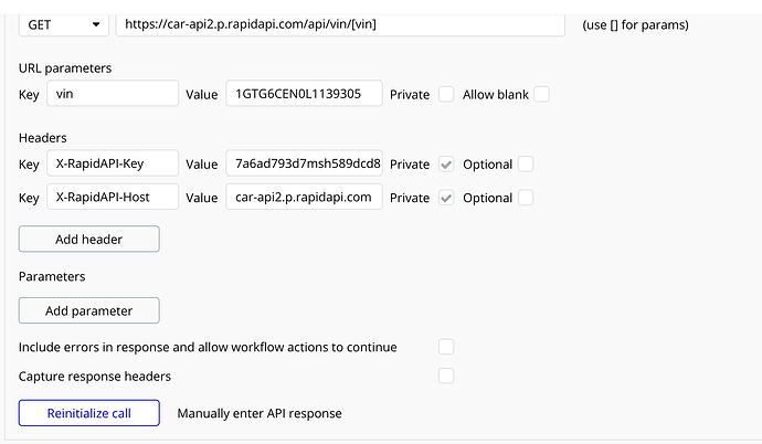

Put [vin] instead of the hardcoded vin. Then uncheck Private
I tried the same, and I did see the response when I used [vin] in the URL, I was able to see the response when I passed the different VIN number and unchecked the private but the response parameters are not visible in the “Design” tab when I use the “insert dynamic data”. Not sure why the response data is not coming in the design tab. Am I missing something?

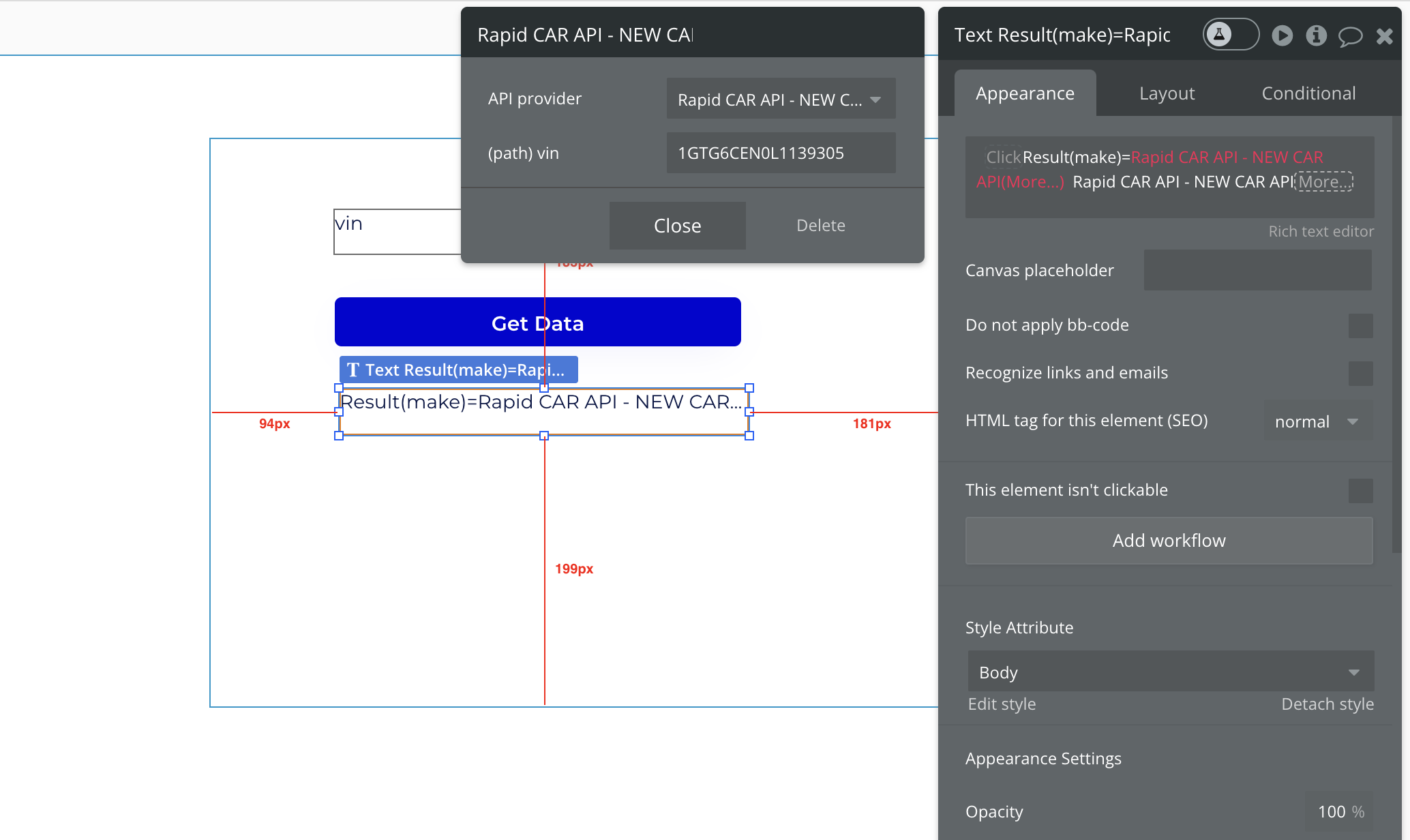

That little window that popped up on the left, you just click on the white text VIN number and delete it and click “Dynamic data” then pick the Input's value
Thanks. There are 3 designs fields that I m using. One text is for the vin input that is top most and the one in the below is to display the response field such as “make”. My problem is the response values are not displayed in the dynamic data

I tried different URLs and i could able to see the responses based on the input. I am seeing the problem only the URL with passing input using [ ] braces as when I create the workflow during button press, the input parameter value is not available.

No click on the white static text and remove it, then click “Insert dynamic data”
But you have some other static stuff you typed in your text element like “Result(make)=” for some reason, and you have the same API again after it so remove it
