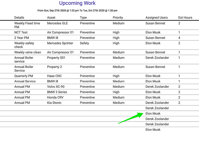

I am using PDF Conjurer to output a report. One of my table columns has usernames. Each record could have multiple usernames on each line item. Whenever I have a record with more than 2 users, PDF conjurer pushes the user data down onto the next row. The result is my users are all misaligned with the record.

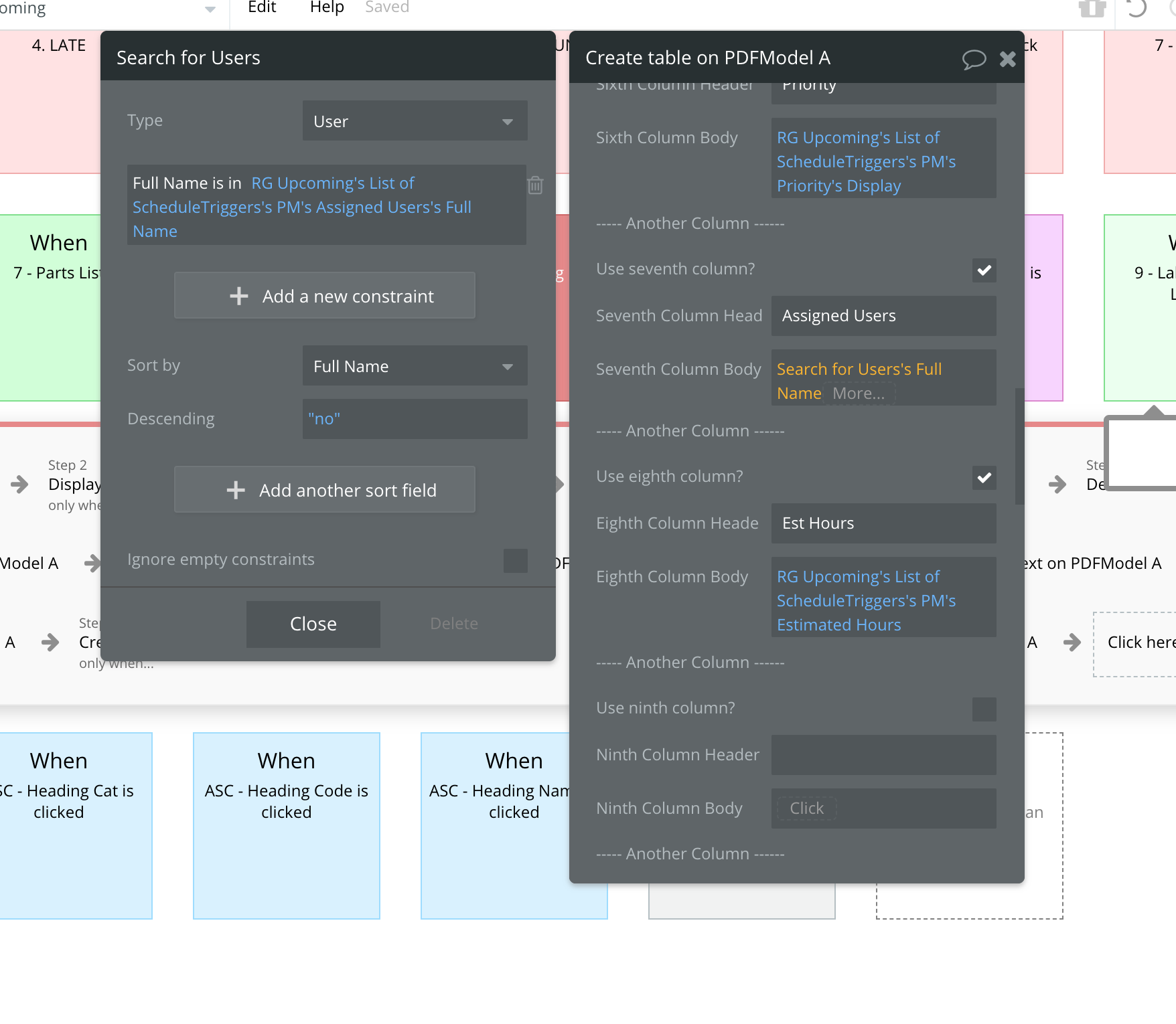

I couldn’t get that working. I tried a bunch of join with combinations:
  1. I tried trying the search a bunch of ways:

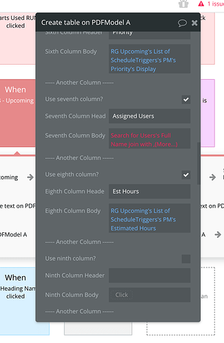

  2. But I always get the error:
Any help in solving this much appreciated. My app is:

Create the error message again so I can inspect it, it’s currently empty.
I imagine that this will help: Place the “join with” not in the end result, which is a list of lists, but in each item’s list.
So each item will pass its list in a consolidated, “joint with”, manner.

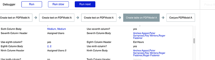

You have more “names” rows because that’s the data you pass in.
Check into the debugger what’s being passed in that field when you get the extra names.
The list is just bigger.
There is 2 records - you’ll see in the sixth column body…

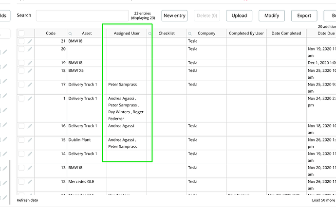

The datbase object is a list of users. So one job could have multiple users assigned to it.
But you’re passing the field “User’s Full name”, that’s a single text field, so you’re passing a list of that.
If that list has 5 names, then you’ll get 5 items in the table.

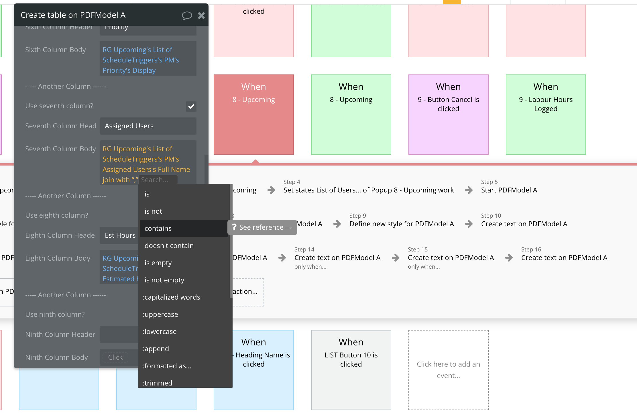

I added the state which is called “list of users” but it is a list of texts, to the pop-up element but I cannot get to the ADD operator. It’s not an option…
Actually. I reread your text and I think I did that wrong. But I still cannot get to the ADD operator.
Set that in the state first.
Element’s state (which is a list) add RG Upcoming… join with ,
It’ll look like this
Popup 8 - Upcoming w…'s List of Users add RG Upcoming… join with ,
