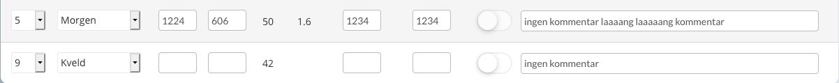

Have some problems regarding the Create table on PDF Model when all the columns are not filled with data.
My example:
Grab data from Repeating groups, store these in Custom states as Things and list of things where I again pull the data into Conjurer. It seems to me that if the first thing (row) does not have data in all the columns, the PDF generation fails. If the first one has data in all columns, but the succinct rows has some missing fields the gen passes with no problems.
This one fails :
This one passes:
Maybe/Hopefully I’ve just missed something in the docs and the solution is simple ??

Thanks for your reply.
There is always data, but if I illustrate one of the fields as a list it could be something like this: ,2,3,4,5,6
I’ve noticed that it only produces an error when the value from the thing passed to the column is numeric and the first item in the list is blank/null. If the list is 1,3,4,5 it seems to pass.(supposed to be two commas , between 1 and 3)
A list of text values like ; ,b,c,d,e will pass and the cell in the pdf is generated but left blank.
Could it be because an empty string is passed as “” and a cell missing a numeric value is null ? Tried to set the default value of the numeric columns in database to have a default value of 0 and then it seems to work. But I would rather have them blank
Maybe I can convert the thing to a custom state where everything is a list of texts and it will work

Tried with the latest version, same result.
If I enter 0 in the field marked in red and leave the field below blank it passes. But if the first line is blank it fails (e is null)
If the data is entered like on the image below, it fails. But if I enter 0 in the field marked in red and leave the field below blank, it passes. But if the first line is blank it fails (e is null)
Anyway, I can bypass/manage it by setting the default value of my numeric fields to 0 in the db.
