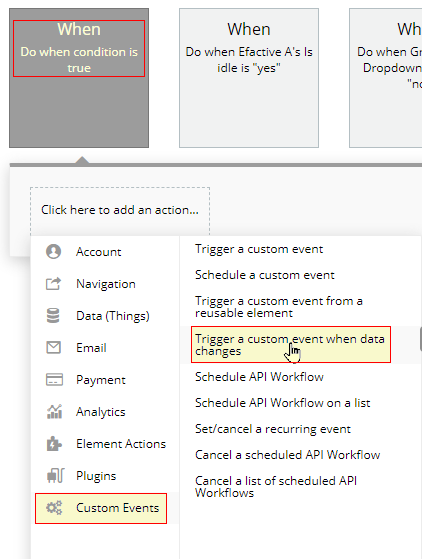

Try using the ‘Trigger a custom event when data changes’ workflow action.
Apply a condition to the ‘Do when a condition is true’ workflow. Could be when a new booking is made or something like that.
Set the workflow event to ‘Everytime’

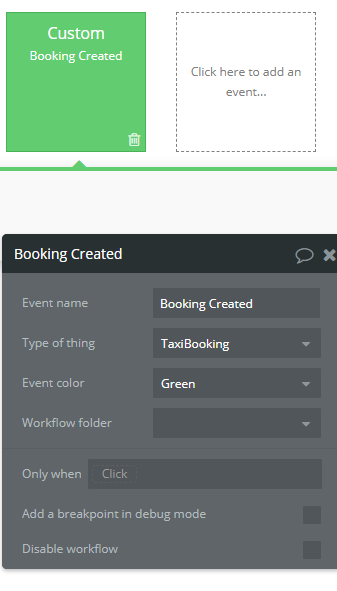

The field to watch would be the related to the ‘Type of thing’ set in the custom event which is ‘TaxiBookings’ with the field to watch then being ‘DriverUser’.

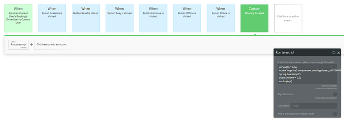

Then on the custom event could be the JS for the audio to play and you could use a condition on the Custom workflow so that only when ‘Current workflow TaxiBooking DriverUser is current user’

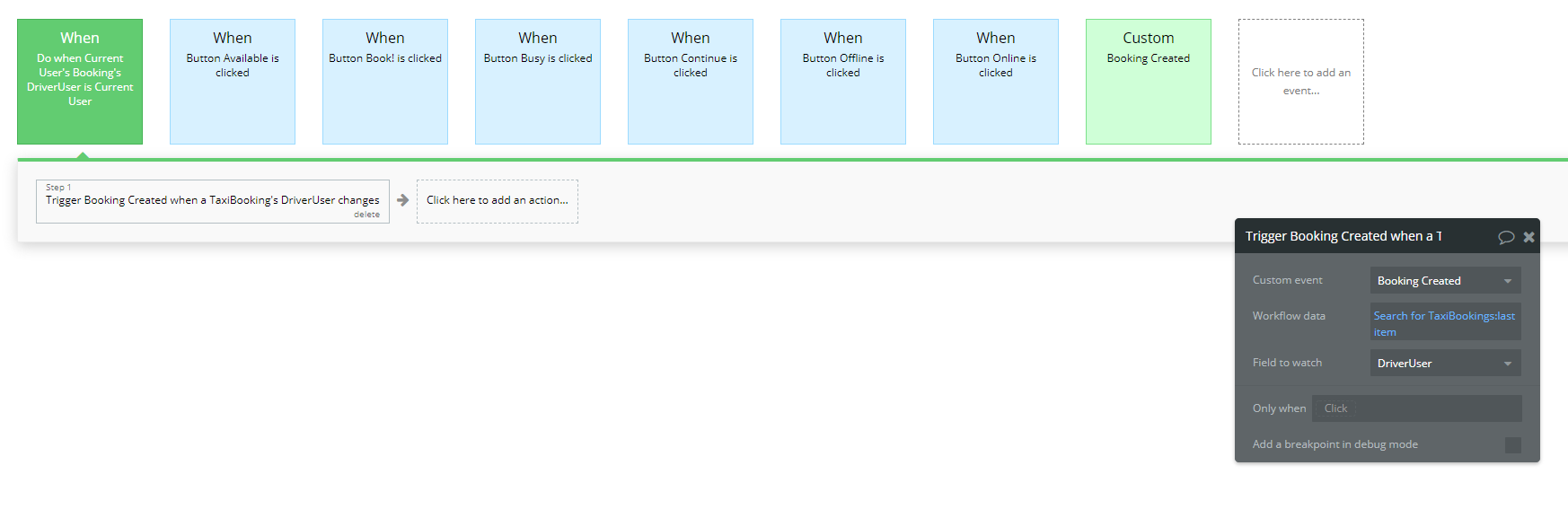

Is the bit where I’m a little confused. What should I put here?image
- Custom Event
The Workflow data can be the repeating group (if the data type matches which is should do) or you can ‘Do a search for’ and filter/constrain any data you need.
Don’t know if I am being stupid here.
Try :Last item as its expecting a single item. The last item should be the latest, can also be changed with the :sorting modifier to most recent (from the created date) as last entries.

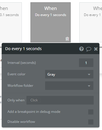

Create a new workflow on the page:
You can set the interval to lower values e.g. 0.5, but for performance I think 1 is fine.

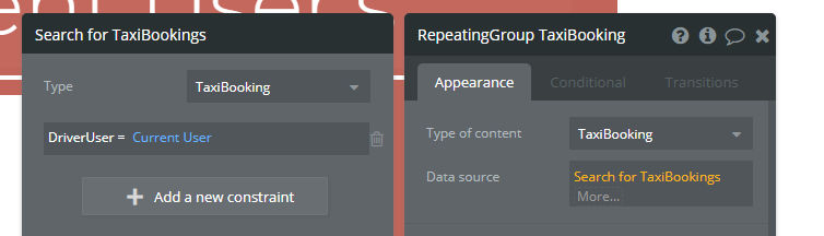

Now in the repeating group we are searching for entries on the ‘TaxiBookings’ data type:
The entries will only be show to the current user who is the driver. Privacy rules would need to reflect this too.
