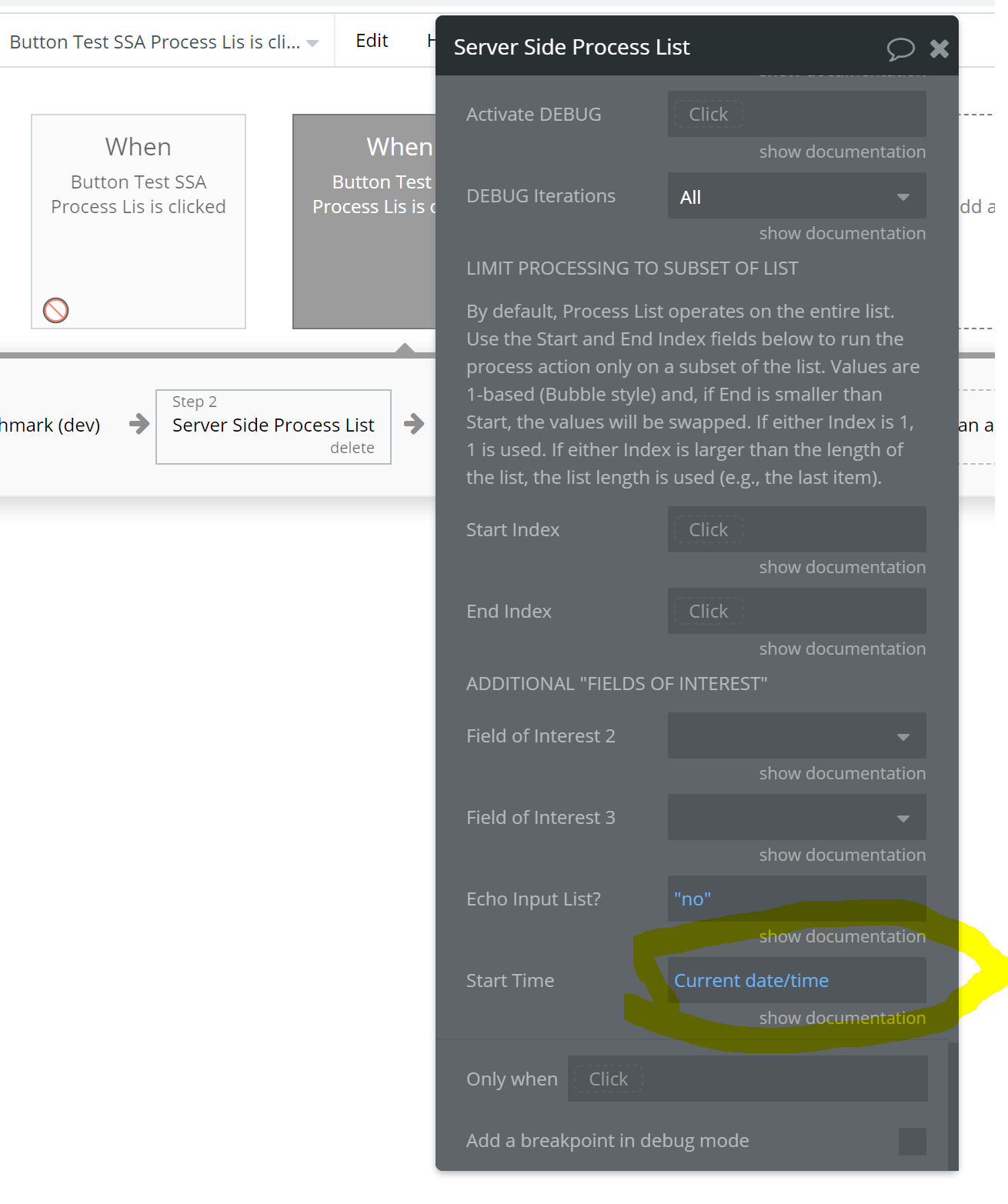

Here’s an example. Here’s a date field input to an SSA:
And here we feed a date to that input in the editor:
And what we find if we inspect this “date” is that it comes across as a string, not a date.

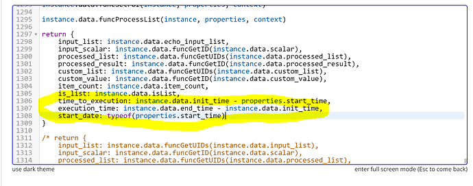

I discovered this as expected time math was not working. You can see both things here. Here is our return code:
You’ll see that the return field for time_to_execution
should come back as a number (the subtraction of one date from another, but it returns null
). The reason that returns null
is that the type of properties.start_time
is not a date, but a string.
Here’s what happens at runtime:
You’ll note that Time to Execution comes back as null
because we have attempted to subtract properties.start_time
(which is a erroneously a string, instead of a date as specified) from instance.data.init_time
(which is a date).
That properties.start_time
is a string is confirmed by the fact that Start Date comes back as “string” (because what we are sending back here is typeof(properties.start_time)
, which should report "object"
, but properties.start_time
is erroneously being sent as a string.
