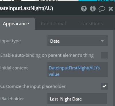

Hi. I am using the Full Calendar plugin from Bubble. My data saves a Start date and an end date in the workflow as a date input
Even though the input type is Date only and not Date and Time when I save the date in the workflow it ends up with a time as well and the time is alway 12:00 am
This creates a problem. If I use the Start Date as the Start Time field and The Last Night as the End Time field the end time always shows as the previous day even though the data field is showing correct. It also leaves gaps in my Calendar and “12a” showing before each Caption which I can only assume to be 12am.
I can only assume that the calendar is reading the time as well and ending the field in the calendar at midnight and therefore not showing the actual Last night as the End Time.
How do I get the Calendar to show the End Date field as the actual date of the Last night and not midnight and therfore not showing the last date on the Calendar plugin. I have tried saving the date field in the workflow changing the hours minutes and seconds to 0 but is still saves in the database as 12:00 am
This still gives me the same result in the data table as 12:00am and that date not showing in the Calendar plugin as the actual Last Night
Any suggestions of when I have it wrong here?

    – you can use either of the above to set the date field based on an offset of another field’s value: LastNight = DateInputLastNight(AU)'s value add hours (4), for example, would get you to 4:00am, in your example where the default you’re collecting is just the date (and thus Bubble defaults the time to midnight).
