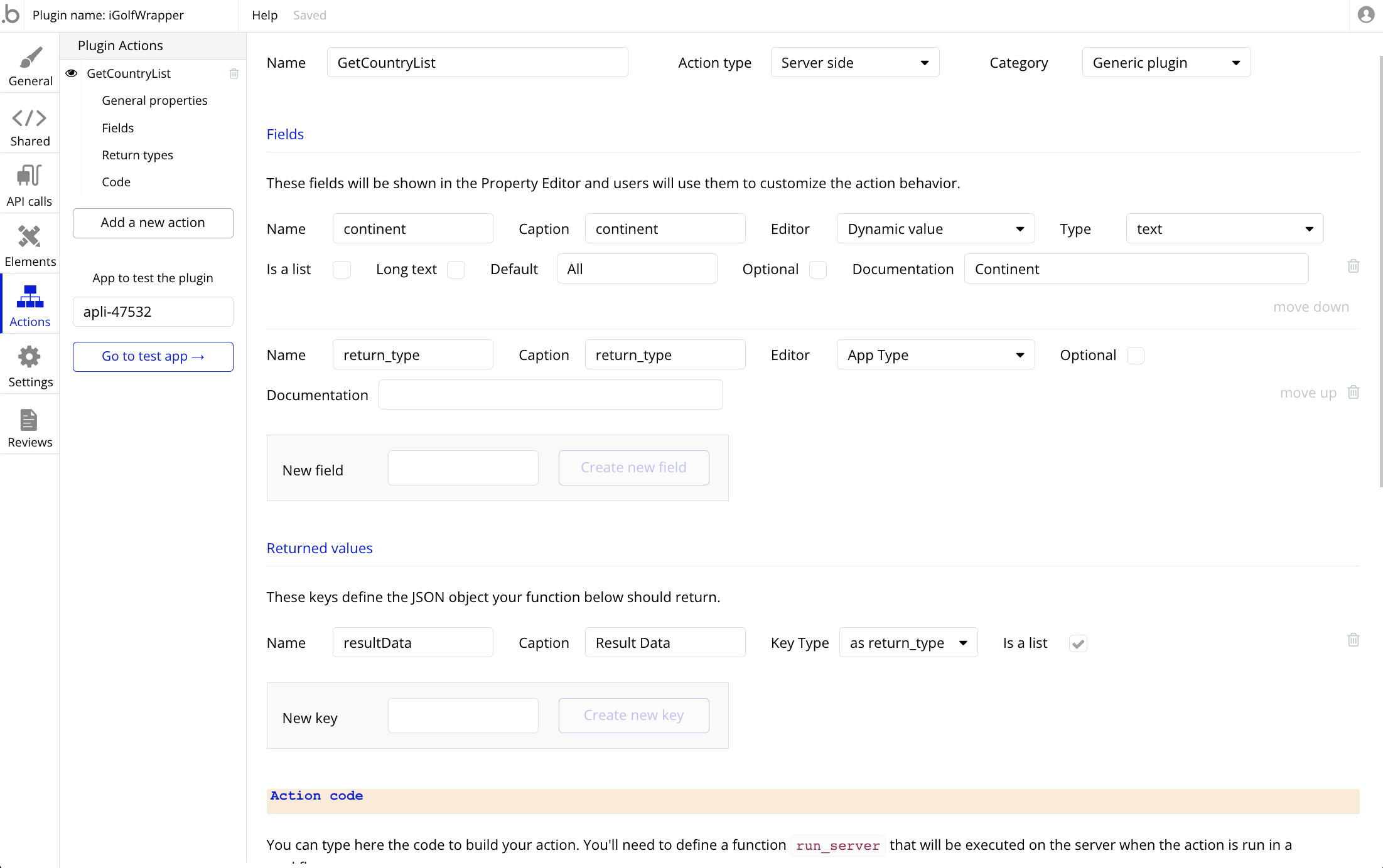

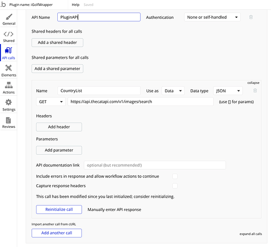

I am creating a plugin that will have different actions to return different sets of data objects from a external API. I am not using the API connector because the authentication requires a HmacSHA256 signature in the API url so this is why I have went with creating a plugin to make the API request and then return the data. For the first API call I am testing how to return the country list from this API. I am able to see that the plugin is successfully requesting and receiving data from the API and logging it to the server logs. Please see my code below. Any help would be greatly appreciated.
Followed example for recreating a Dummy API call and manually created the object for the response.
Setup my parameters and response based on the article.
Here is my code:
Like I said I have validated that the code is working and returning results as you can see below in my response. I can’t figure out how to return it from the workflow to the UI

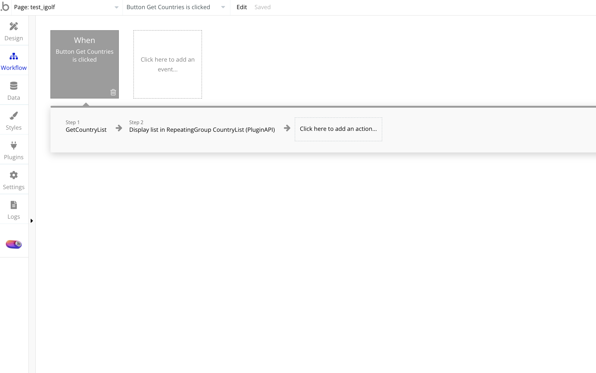

Workflow error - Plugin action iGolf GetCountryList error when parsing the response: the key 0 is not part of the btype definition
Workflow
Design
Thank you for your time and I hope I have provided all information necessary. I’ve been beating my head against the wall on this and would like to figure this out. Otherwise I will create a separate API to do this for me and deploy to Google Cloud.
1: if you are comfortable in gCloud, do this there. it’s faster and cheaper
2: in your return object, you need to prefix in your code with p
start with these 2 ideas
  1. I think you meant _p_ but markdown got into your reply
Yes! Thank you
hey thanks for the response but when I add “p” to the beginning of the object properties I get the same error returned from the workflow.
Plugin action GetCountryList error when parsing the response:
Any other ideas?
