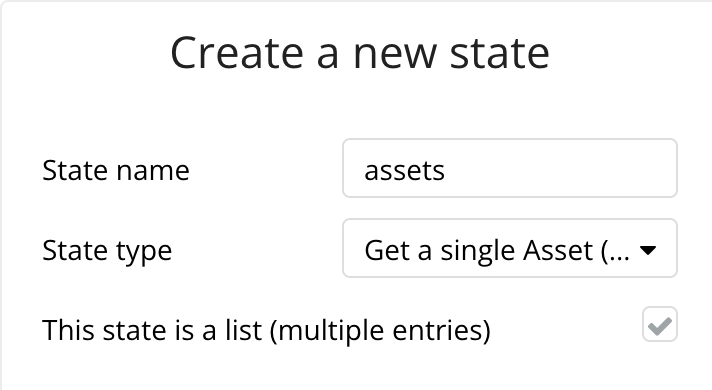

Yes you are right, I have all the tokens ID
I think it’s not possible to call Get a Single Asset API on a repeating list
For my understanding we cannot use a list state when using the Single Asset API (to call a list of Token ID). And as I am using a repeating list, the state of this API function (ie Token ID / Contract) cannot be changed on each boxes of this repeating group
But to be honest i would prefer to call the assets one by one rather than calling every assets and then filter the result. It will avoid to overcharge the API and will permit to make the app smoother
Hope my explanation are clear
You could do a custom state that will be a list of Single Asset like this:
and then, when setting the state, use the ā€œplus itemā€
