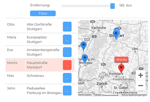

I am also keen to know if you will be implementing the feature that @mirko.heimburger suggested awhile back where mouse-over google map marker trigger a condition on other elements (such as on RG) and vice versa, see below extract from his earlier post:
I need this feature for my real estate app and hope this is in your planned release.
thanks
