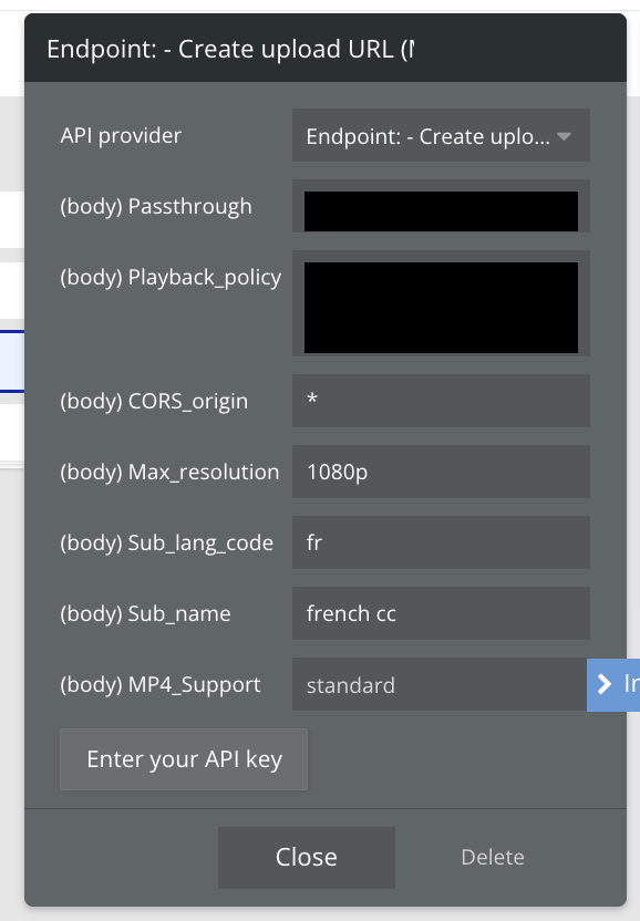

When I want to create a new asset in Mux, I have this error :
In text:
The service Endpoint: - Create upload URL (MUX) just returned an error (HTTP 400). Please contact the plugin author directly for feedback. Raw error:
{“error”:{“type”:“invalid_parameters”,“messages”:[“Deprecated ‘sanitized8’ mp4_support is not allowed on basic assets”]}}
Here are the details for the endpoint in question Create upload URL (MUX):
Value for MP4_Support is standard.
I have tried to rollback the plugin version to 1.373 (before the version 1.374 about mp4_support) and I do not get this error and can select a file in the file explorer.
But I would like to use the last version of your plugin.
Do you have any recommandations regarding the error described with v. v. 1.377?
Thank you for your precious help
If you change the value from “standard” to “capped-1080p” does it work?
I recall MUX have changed the way the MP4_Support parameter works. They deprecated the mp4_support and replaced it with static_renditions. I need to change it in the plugin, which I will do soon.

Yes it is working!
As usual, thank you for your quick and precious support :folded_hands:
