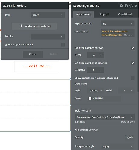

I need help with the first part of this.
The attached screenshot shows that all I get as an option is “each items design files”
If there is 1 file in the list it shows in the repeating group.
If there are 2 or more files / filenames it wont show.
the repeating group cell is set to dynamic image - current cell’s file
Have you inspected the element in debug mode? What does it say there for the data source?
