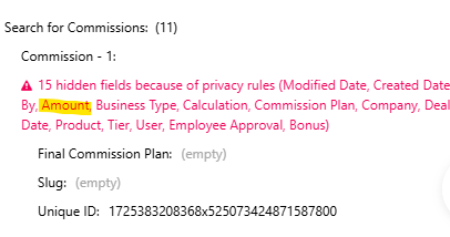

I have a privacy rule on a table that allows the items to be found via search but there are no fields set to view access.
Despite this, I can see that users are able to see data that is summed from values coming from this table. See the debug below where the privacy rules are clearly in place, no “Amounts” are found as expected, however the sum function is returning the value for those amounts.

I have a workaround for now, but it seems incorrect to me that any piece of something limited by a privacy rule can be seen in aggregation.
I have other calculations that return a sum based on grouping that correctly do not show so it does appear it is purely related to using sum or similar aggregation of a field.
