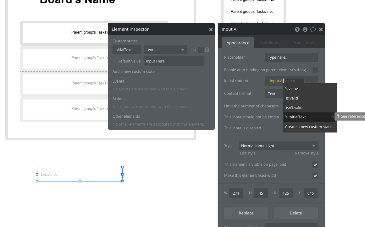

If you set the Initial Content to read from the item’s custom state, and then set the state on the button click, that should do it.
Hey @david17, thanks for the reply. I’m not having luck finding out how to “read from the item’s custom state”. Can you point me at something that helps me understand this concept?
If you click the (i) on the element in the top right corner, you can add “custom states”. This state can have a default or be set at any other point in the session.
As long as you have not edited the input (that’s when the initial content is disregarded), the input’s value will be the value of the state.
