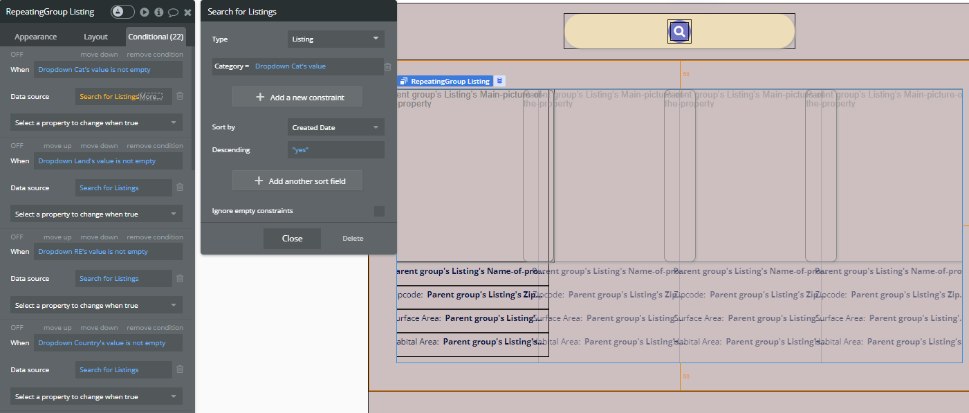

When I filter my RG I have this issue:

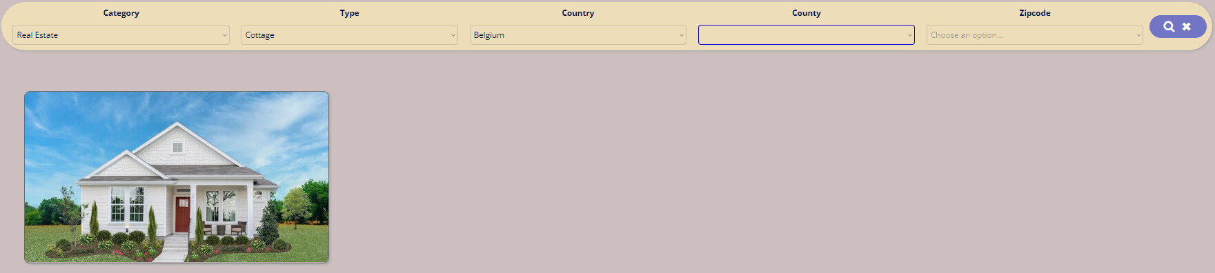

I want to filter a list of houses.
But when I fill in the County suddenly I get more listings that have that County without taking the other fields in consideration:
The 3 extra don’t have the values from the first 3 fields.
What am I doing wrong?
Thanks!

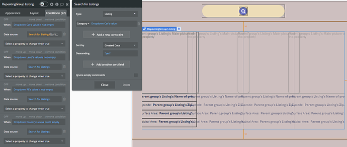

Hi there, @pieterC3… you are using conditions (and lots of them) incorrectly. You should be adding constraints to the repeating group’s data source, and you want to make sure the Ignore empty constraints box that is associated with the data source is checked.
Best…
Mike
