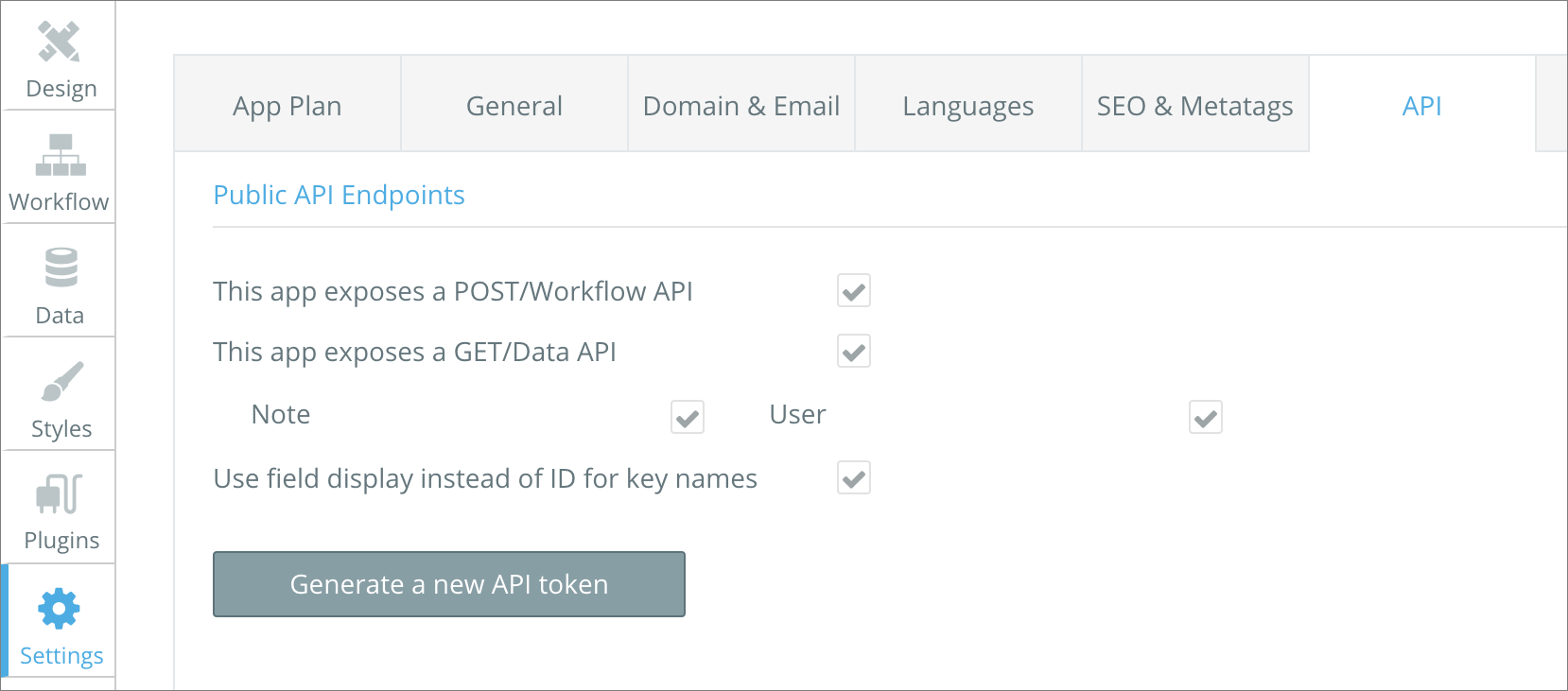

In the API documentation that talks about the Bubble Privacy tab you say:
“If you don’t want to implement user management and simply want all of your API data to be retrievable without the user logging in, you can skip the privacy setup and use an API token from your Settings section instead.”

  1. When you say “skip the privacy setup and use an API token from your Settings section instead” then for the above example, I would just tick all my data table checkboxes? Is that correct?

  1. This isn’t something I’ve tried to implement, what you’re describing is what I would try (if you’ve handled who can see what in the workflow logic I’d expect you not to need privacy rules) but you will essentially need to test it to verify whether it works that way in practice.
  2. As far as I know this will be correct if you just plan to use your general API token for auth.
