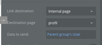

I think UserMirror is a good move - but there is also the next action which is using the link I have in the RG and sending the data to the next page - and what kind of impact will that have on optimizing the page load of the next page.

I’m thinking that too. I will be sending Parent group UserMirror’s User so should be the same it terms of page load speed
