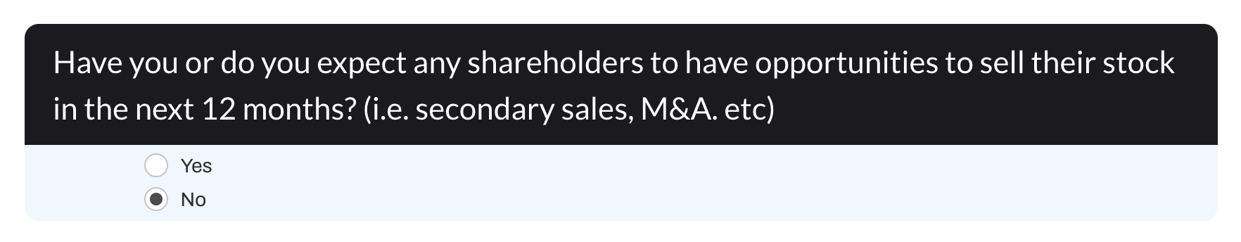

I have created a simple survey app, and am using radio buttons for a few of the questions. When editing the app, the labels align nicely with the radio button and the bullet for the selected option is centered in the circle. When I preview/deploy the app, however, the labels are displaying below the radio button and the selected bullet is off-center.
Editor:
Preview:

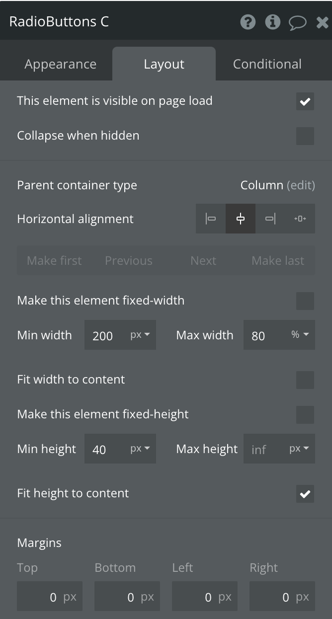

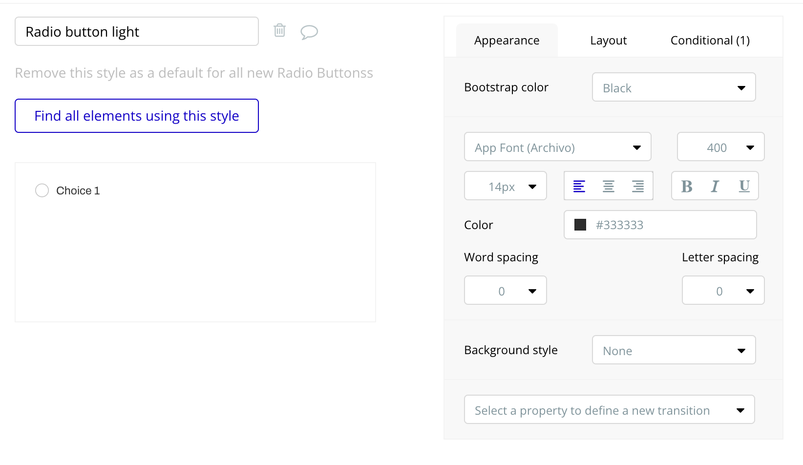

I have looked at all setting I could find in the radio button element and the radio button style, but none of them seem to fix the issue.
Any ideas on what is causing this?

I had the same problem.
However, I identified the source of the problem to be the IconButton plugin. Uninstalling the plugin reverted the radio buttons back to their default display.
Nice catch! Thank you!
