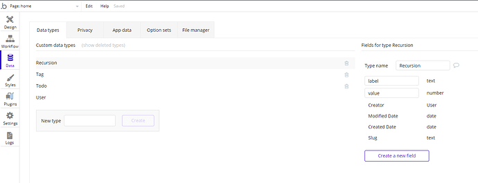

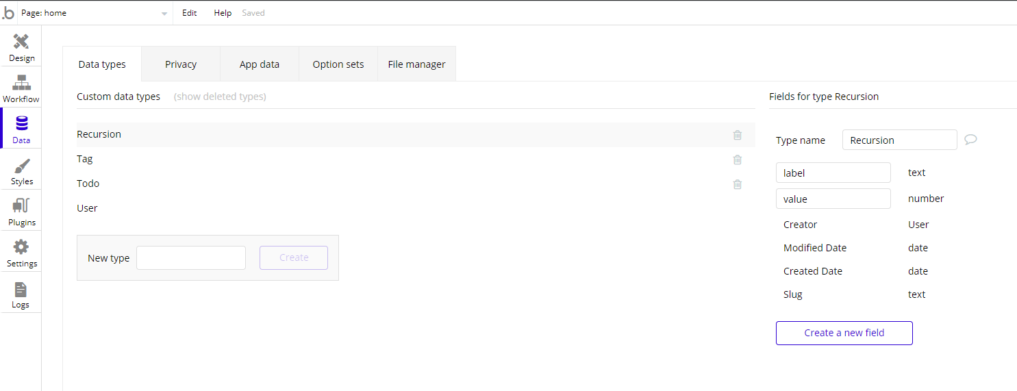

I’m practicing on a todo list. Trying to set a recurring interval for todos. I’ve created radio buttons which contains 4 elements (Not recurring - 0, every day - 1, once a week - 7, once a month - 30, which are coming dynamicly from a new data type called recursion, which has a label and a value ) and I would like to set “not recurring” as default value. But “Default value” field does not get focus when I click on it. I have also an issue regarding to that “Todo recurring: Default value should be Recusrion but right now it is a text”. But as I said, I am not able to write anything into that field. See pictures below:

In default value do a search for recursions: first item (with the constraint to find the unique id of the one you want).

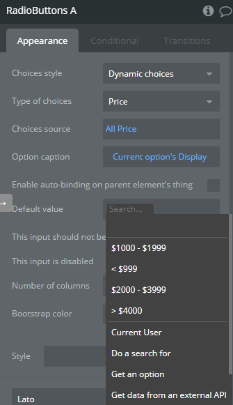

Alternatively, you can avoid using recursions as a data type. Consider setting it up as an options set.
Below an unrelated example using the options set of a range of prices:

But unfortunatelly I’m still not able to click into the “Default value” box to set any value. If a hover the inputbox of default value, the background gets darker, but my cursor does not appaer in it, does not get focus.
