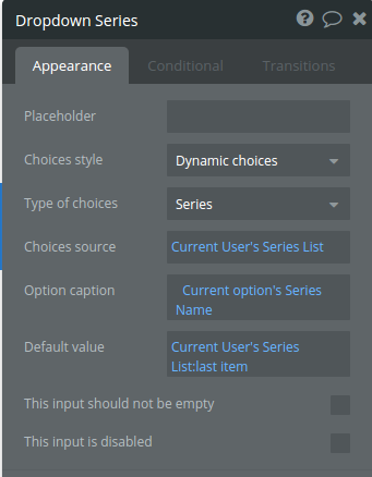

I’m trying to set up some dropdown boxes:
  1. They already have lists, and I would like them to be in alphabetical order. This is simply "Current User’s Medium List:sorted by Medium name."
  2. Then, when the User clicks the ADD button, a PopUp appears, and the User can add to the list. This should then be seen in the dropdown box. This I can do with the default value Current User’s List:last item.
Clearly, I can’t have both as a default value for the dropdown box.

So this is the new dropdown box of DATA TYPE “Title” and ADD popup to add a new “Title” to the dropdown.
We have a number of FIELDS that we want to add to the database, in the Data Type OBJECT, so I guess group 1 in the image should be TYPE: OBJECT.
Then there is group 2, which I guess should be TYPE: OBJECT Title.
BUT it can’t be, as it’s not possible to state this. So I’m lost here. (It’s currently set to OBJECT too)
Then, in the workflow, when a user clicks ADD, a popup appears 3, and the user can add a new Title, which goes into the list. This all works just fine.
But now I want the Dropdown to “display the latest added title”.
I’ve tried a lot of variations in the workflow, at the level of the Popup, but nothing seems to work.
How do I make this happen?
