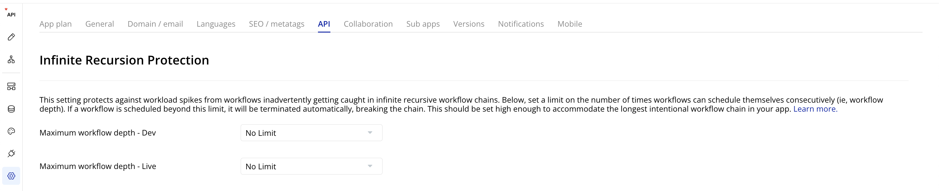

Do you have recursion protection on?

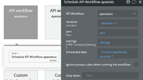

I just did a simple test - with a very simple recursive backend workflow that should trigger itself every second indefinitely (don’t do this unless you are watching the log), and watched the log. It never triggered itself.
Check this setting isn’t too low @brandon10
It is set to No Limit. Like davi.mendes’s initial post, the recursion had been working fine and only stopped working recently.
