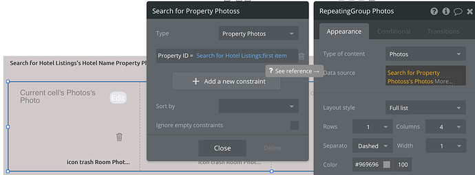

Then on the page I have the following setup to display this information (currently I have more than what I will ultimately, but this is for testing purposes)
This is displaying all photos in the Data Type of Property Photos:
Next I have displayed the photo list of each property room:
What I am doing for functionality is to allow a user to click the trash icon in the cell of the photo in the property room to open a popup that gives them 4 options of deleting the photo. One option is to delete it from the current room (the room the photo displayed in the repeating group on page, the one they clicked the trash icon from).
