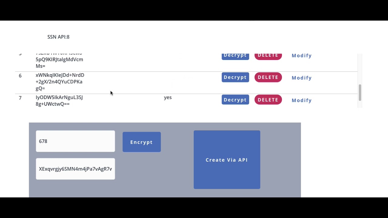

I have a count at the top of the RG as well as a cell index number in the cell to double check this…and although most times the RG is refreshed, it doesn’t return all the results properly.
The video below demonstrates what I am experiencing. Any ideas why it wouldn’t be working properly?
In the video I start with 6 results from the API…the first creation and refresh works fine. The second has a lag before it updates the count…after that there are 3 more creation and refresh attempts that do not update the results. It is not until I refresh the page that the final 3 creations are in the results bringing total count to 11.
