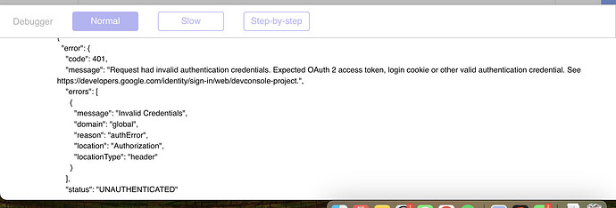

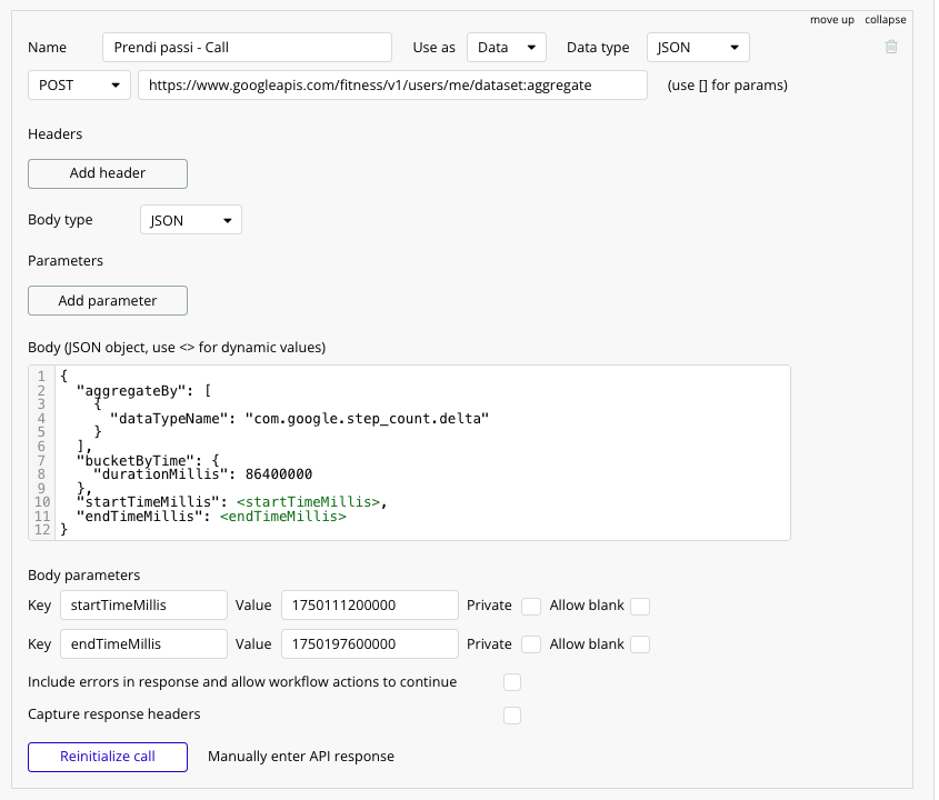

Hei guys
I ve created an API to connect to Google fit.
After 1h, I have to refresh the token. I can’t find the way to refresh it without logging in of the user again to its google account.
Here the screenshot.

The token in API connector is never refreshed. This is only done for your user. Are you talking about the expiration in API Connector itself?

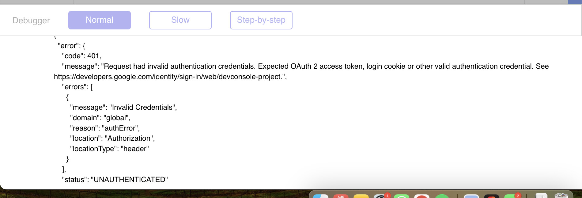

hei @Jici After one hour i receive always this. I m not sure what is it

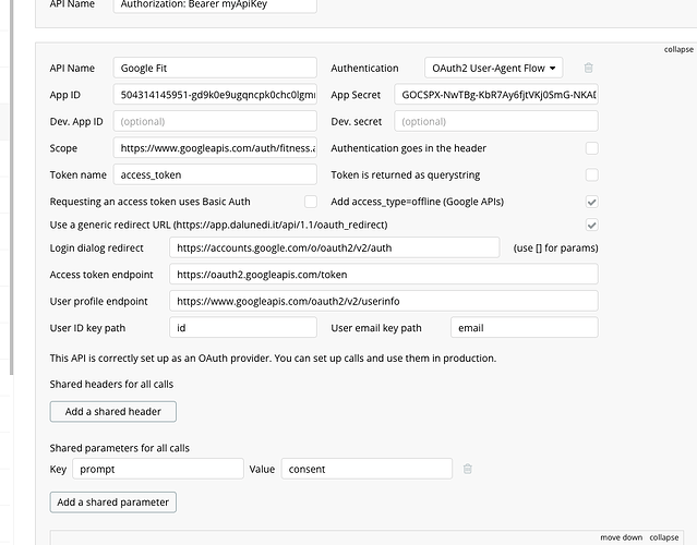

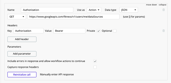

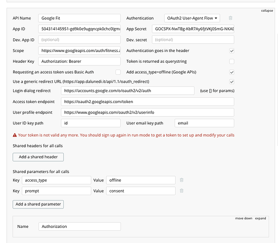

In your last screenshot, I can see you added an Authorization header. Delete this from all your call because this create conflict between what you set and user-agent auth. Bubble add the authorization header to all your call, you don’t need to add them. Also, remeve shared parameters for all calls. This is applied to other call, not to the auth flow. You don’t need this. Finally, Ican see you have Authorization API call set under your auth. this is also not needed.
Don’t use manual auth like @wirthitconsulting suggested if you don’t need to.

Set Authentication goes in the header. also, this is important that user allow this in consent screen. if you already have the user created, it won’t work until you go to consent screen again. So you may need to add ?prompt=consent to the auth url (login dialog redirect). Delete it from shared parameters.

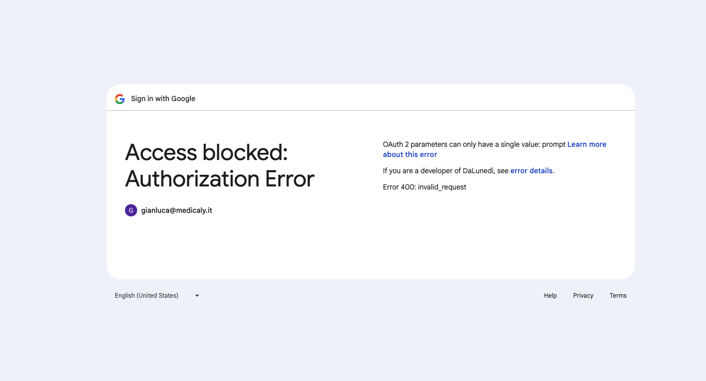

I disconnected my gmail with my app before proceeding.
I added ?prompt=consent to the auth url and deleted the shared parameters but then it gives me this
Can you share the url and what you have set? I don’t think Bubble add it automatically, but maybe…
