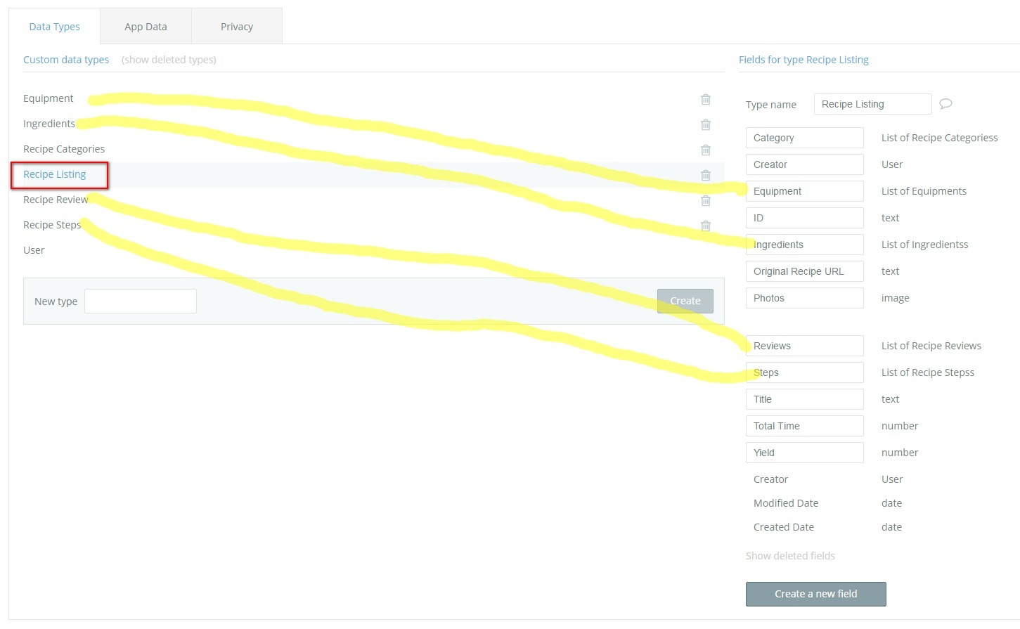

  1. In Figure 1, the primary “Recipe Listing” table is related to other tables (such as Recipe Steps). Is it correct to reference these other tables as “List of xxxx”, or should they be referenced as a single entry (xxxxx)?

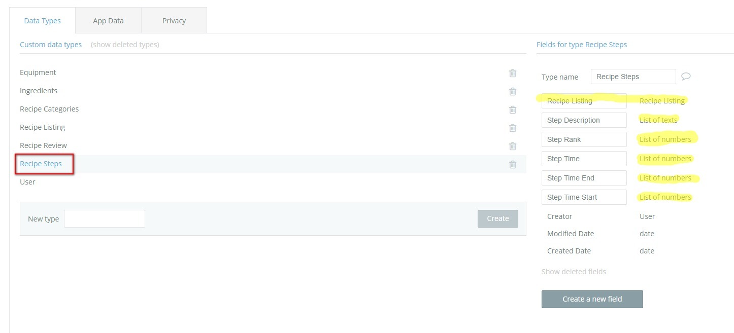

  2. In Figure 2, the “Recipe Steps” table is shown. Each field contains a data array. Do I need to add a separate unique key field to link the two tables? Or, is it configured correctly using the Recipe Listing field?

  1. Would seem fine, that looks like a good way to do it. You have also linked back from the listing step to the recipe (assumption is that a step is only relevant for a single recipe listing) which can be helpful. You might also want a list on the equipment and ingredient tables as well, as that can make life easier at times. But it does depend on what you are trying to do.
  2. I think this one will get complicated, I would suggest that having the multiple arrays isn’t what you want. You want a single “step” thing that has the step number and text rather than in two arrays. That way you can simply list out all recipe listing steps ordered by step number. You probably don’t want to have unique ids linking things, embeding (as you have done) is far far easier in almost all cases.

In the Recipe Listing data type, the “ID” field is the unique identifier. Should I include an equivalent “ID” field in the Recipe Steps data type to link the steps to the recipes? Else, how is the link achieved?
Yes, you will need the step to refer to the recipe I think, that would be useful anyway.
Hopefully that is the right way round, it is a while since I did a csv upload, but essentially you use a field to search on another thing to link it.
