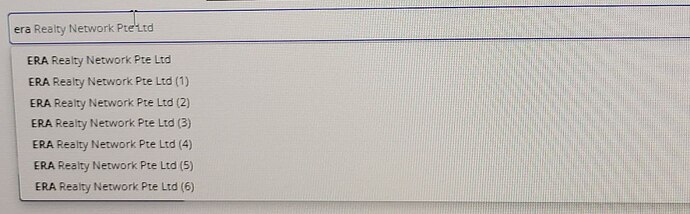

Hi Bubblers,
I’ve searched about this in the forum and also in online resources but didn’t manage to find any useful resources.
Would anyone have a solution to remove duplicates like in the image below without having to create a new table with unique records?
If they appear with (1), (2) etc in the dropdown, probably, they have their own record in the database. So, they are separate elements with some difference, so Search for XXXXX:unique elements wouldn’t work in this case and you have to do some manual filtering.
If you didn’t mean to add these 7 times, then your add logic might require some change.
Maybe give us more context.
@bkay grab this plugin to apply to all the pages in your app - Searchbox: no duplicate Plugin | Bubble
Or grab the code from the plugin and apply to any page you don’t want to show duplicate values.
Next, as the searchbox is showing various records with ‘ERA Realty Network Pte’, you’ll have to play around with displaying the values that you would like the end search to utilise. (e.g. other parameters you may be using).
Good luck!
Hi @hergin , thanks so much for chiming in again and appreciate it! For a search for company, I’m using the data table to query which includes projects from that company so I mean to add them 7 times because they are uniquie projects of that company.
Just wondering if there’s a way to remove duplicates when displaying in searchbox without having to create a separate table for companies
