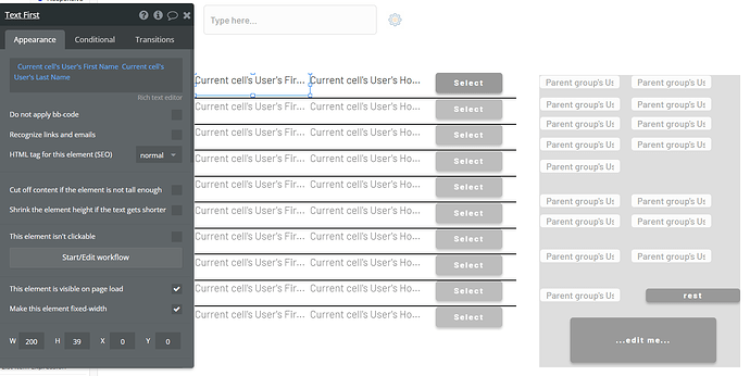

currently building an admin page for my app which uses a search function to display data in a repeating group. There is a button that opens a popup with the user data that is due to be edited via auto binding. I have about 10 inputs on the pop up for the user data but only 4 are actually displaying the data.
They are currently designed to use the repeating group as a parent group and have an identical approach.
Any idea why only a few are showing, despite all the code being the same? Am I missing something?

I have removed the pop up and instead placed a group next to the repeating group to pull the data from the repeating group and edit. I am only going to be searching by two main criteria, possibly 3 (ID being the third). You can see that some data is being shown in the second group but not all of it. The settings/workflows/dynamics are the same so not sure whats happening.
the debugger did not give much away, some of the inputs said they were empty but I do not know why…

Thank you very much! I have just had a look and there seems to be an issue there so need to go through and edit the privacy settings. Thank you very much for that, I shall let you know how I get on!
Hi Mike,
Thank you very much for your assistance! Problem solved with an admin Yes/No data field in the database. Another learning curve for me! Thank you!
