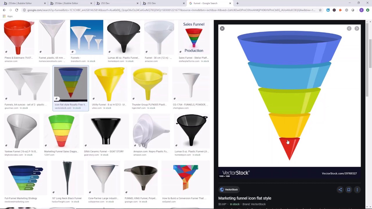

this video is a bit long and tedious but goes into the method
