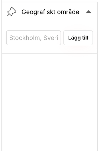

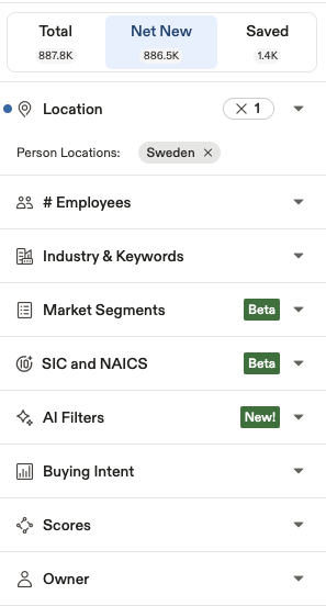

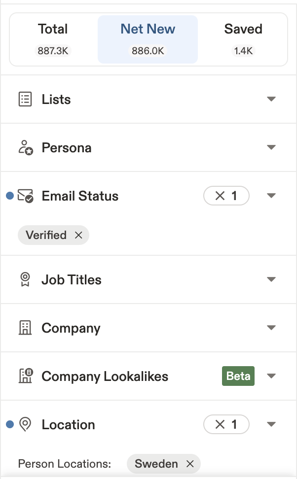

Here’s my current plan: I’ll have a filtering menu on the left side (like the one below). Instead of updating results immediately whenever someone changes a filter, I’ll have a “Save changes” button. My assumption is that this approach saves more WUs than updating in real-time, but please correct me if I’m wrong.
Now, here’s where I’m stuck: let’s say I have an input field with the address content format. When a user types in an address, Google API suggests the correct one (e.g., “Stockholm, Sweden”). Then they click “Add,” and it gets stored in a repeating group (I’m thinking this would be stored as states?). The tricky part is that these states need to stay in sync with the URL parameters and vice versa. For example, if someone pastes the link, the filters should be pre-filled visibly so they can edit them if needed.
