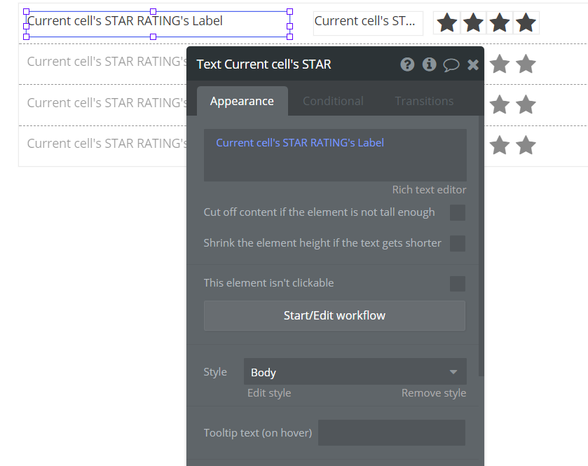

This is the page with the Repeating Group. The search goes to the table “STAR RATING” used for this example, that has only two fields: Label (a text) and Rating (a number). Your data will probably be different.
I assume you already know that the RG uses the variable Current Cell to display values in each row. If you don’t understand this part well, you may want to go over the tutorials and Bubble manuals. This is a fundamental concept to understand when using Repeating Groups.
In the top row of the repeating group is where you put the fields that you want repeated. In this case I’s showing the label and the rating directly from the table and 4 icons.
The two fields to the left are text fields that will display the two fields in my STAR RATING table. here’s one of them:
In each of the four stars, I play with the conditional tab. YOu will see two conditions:
One to change the default colour of the icon to a light gray whenever the icon is visible and the other to change it to amber when the star needs to be “added”
This simply uses a rating from 0 to 4 but you may want to change the conditions to anything that best suits your needs. In my case, I change the second conditional in each subsequent star to change the icon color to amber when the Current Cell’s STAR RATING’s Rating is > 0, or > 1 or > 2 or > 3.
