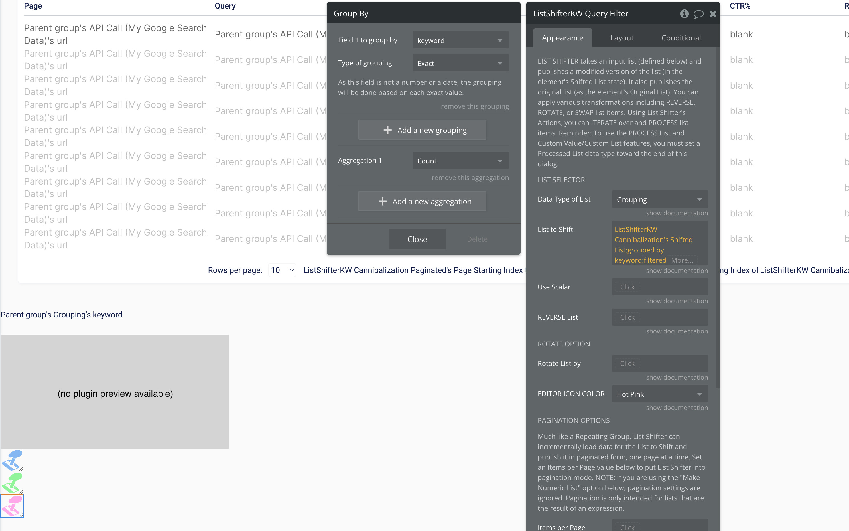

Sure, although I think my use case is quite different to yours.
My use case:
I am pulling data back directly from the Google Search Console API and I want to show the user where they are ranking for the same keyword more than once.
So basically, create an RG that shows duplicate (exact match) keywords.
So, in my case:
I have created a List Shifter element that holds the list I want to compare against (lets call this List B):
I am then Grouping by ‘Keyword’ and then ‘Filtering’ Count > 1 (this is because I want a list of all keywords that have/are duplicates)
Then in a 2nd List Shifter element, I am grabbing List A and filtering it to only show me data where the keywords are in (‘is in’) List B.
Then I’m using that 2nd List Shifter element as the source for my Repeating Group.
One of the problems I hit which took me a while to figure out is my query was actually working but my RG was blank because I have it paginated to only show N rows per page. Because I had my filter in the wrong place (in the RG, not the List Shifter element) they were actually in the RG but not on page 1 (by luck I clicked through a number of pages and noticed there were keywords appearing on page 5, 8 etc. etc. Because there are a lot more unique keywords in my dataset, when I changed the constraint to ‘is not in’ I could see them on page 1 (hence why I thought ‘is not in’ was working and ‘is in’ wasn’t). Rookie mistake :man_facepalming:
