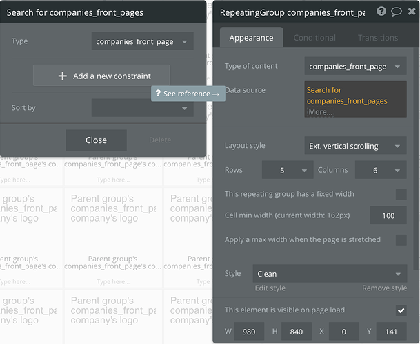

For some reason my repeating groups are loading so slow right here: https://companyone.bubbleapps.io/version-test/companies3
Please select country “Andorra”
It just loads 1 entry at the time. That is a little weird.
I m using this search:
Any thoughts?

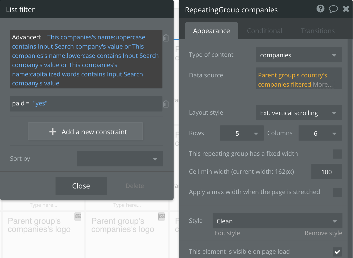

“Advanced” filtering are made client-side I think. It means that the client load all the data first before fitler them.
I would advice you to avoid “Advanced” filter as much as possible, especially when you need a fast loading.

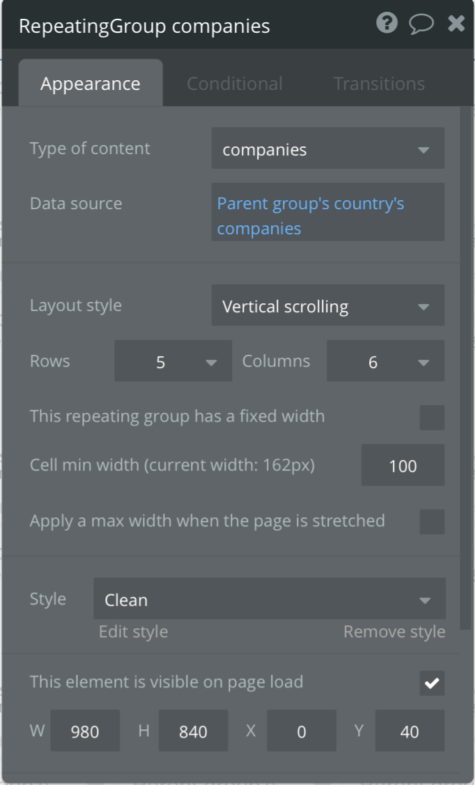

i just removed the filtering and it s 100% the same https://companyone.bubbleapps.io/version-test/companies3?debug_mode=true. i get 1 entry by one
If i change the repeating group to vertical scrolling it works ok
Filter in general is client side, it’s better to have every constraint in the search if possible.
i have done it that way now but if i select ex scroll bar, same thing happens.
is it because i search within a list of things? But the weird thing is that, when i select the option with vertical scroll bar it works like a charm
So @emmanuel. Here you can see: https://companyone.bubbleapps.io/version-test/companies3
and this is what i have: simple search

Please see here the difference between Ext. Vertical scroll and Vericall scroll

It’s the same speed for me on a MacBook 13. Is your screen big? if so, that means in ext vertical scroll it loads more entries, and take more time.

i have clear all the cache and everything. it works ok now. But there is still something. More i load, harder it loads the items. Could you check on the same example? Maybe a “Load more button” would help, in case the user gets to an end but there are still results to be loaded?
I don’t see that here, it’s quite fast.
can you reach the end? i have the last entry called"the end". I can t get to it
Also another remark, in Safari, if i refresh the page, and search again the same thing it gets stuck. I need to clear browser cache in order to load the results at a regular speed
I think something like this would help a lot:
You can implement that yourself with this https://bubble.io/reference#Data.Messages.list.limit_to

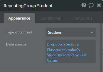

What does your data source look like? I recently made a change to one of my apps the cut down the repeating group loading time by like 75%, simply by changing how I was accessing the data. In my case, I stopped using the “Do a search for…” command and started referencing data objects from somewhere on the page. I’d be happy to take a look at your setup and see what you got cookin

What do you mean by “referencing data objects from somewhere on the page”?

What does your initial data source look like? As an example, here’s one of mine:
In this example, I’m referencing a dropdown on the page that has already loaded dynamic data. Instead of saying, “Do a search for students across the whole system,” I’m telling Bubble, “Hey, you already loaded this classroom into the page, so just give me that classroom’s Students.”
